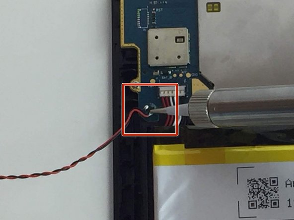

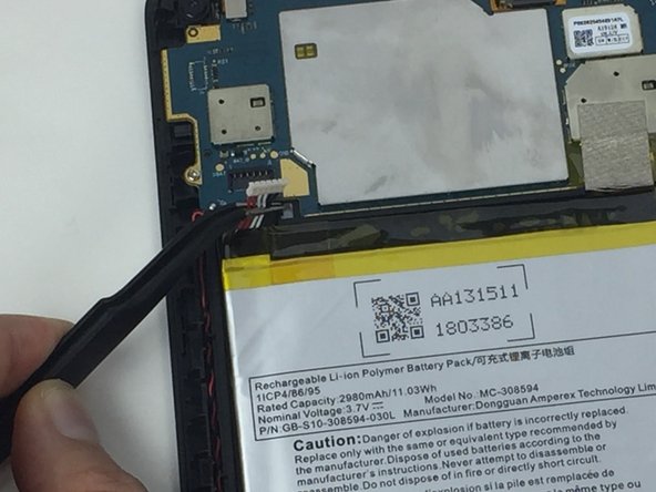

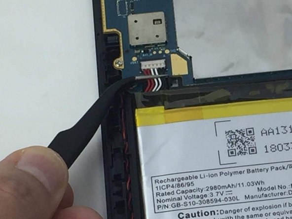

  4. Amazon Fire 5th Generation Rear Camera Replacement, Motherboard: crwdns2935265:04crwdnd2935265:01crwdnd2935265:03crwdne2935265:0 Amazon Fire 5th Generation Rear Camera Replacement, Motherboard: crwdns2935265:04crwdnd2935265:02crwdnd2935265:03crwdne2935265:0 Amazon Fire 5th Generation Rear Camera Replacement, Motherboard: crwdns2935265:04crwdnd2935265:03crwdnd2935265:03crwdne2935265:0
    • The battery connector is located in the upper left corner of the Amazon Fire battery pack.
    • To disconnect the battery connector, use angled ESD precision tweezers to lift the cables up and out of their socket.
    • Make sure you pull the battery connector cables themselves out and not the actual socket. Doing this step incorrectly could result in breaking the connector entirely.

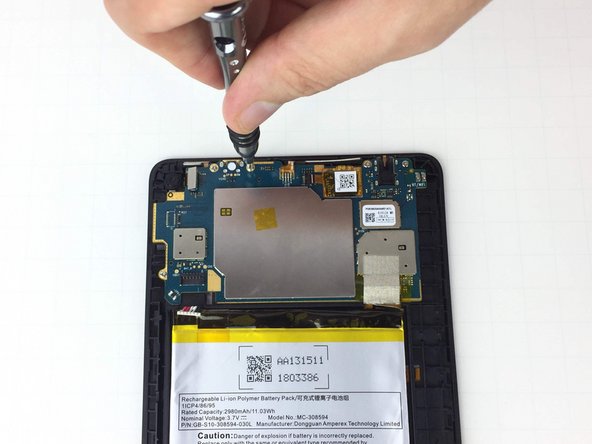

  5. Amazon Fire 5th Generation Rear Camera Replacement: crwdns2935265:05crwdnd2935265:01crwdnd2935265:02crwdne2935265:0 Amazon Fire 5th Generation Rear Camera Replacement: crwdns2935265:05crwdnd2935265:02crwdnd2935265:02crwdne2935265:0
    • Use a PH0 size Phillips screwdriver head to unscrew the five 2 mm screws on the motherboard. These screws are circled with red in the given image.
    • Ensure that you keep track of these screws once removed.

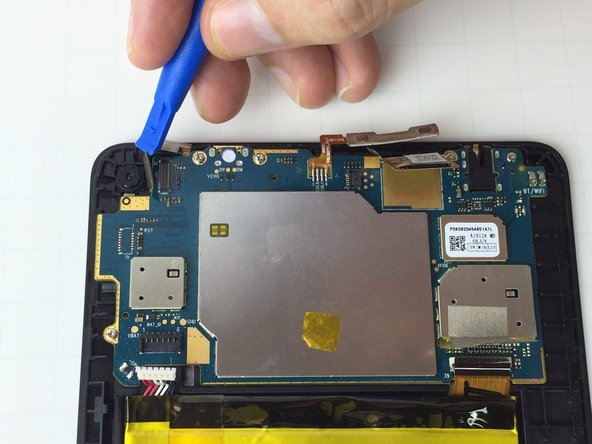

  6. Amazon Fire 5th Generation Rear Camera Replacement: crwdns2935265:06crwdnd2935265:01crwdnd2935265:03crwdne2935265:0 Amazon Fire 5th Generation Rear Camera Replacement: crwdns2935265:06crwdnd2935265:02crwdnd2935265:03crwdne2935265:0 Amazon Fire 5th Generation Rear Camera Replacement: crwdns2935265:06crwdnd2935265:03crwdnd2935265:03crwdne2935265:0
    • The LCD- Motherboard connector cable has a protective overlay that you must peel back with precision tweezers in order to expose the actual connector.
    • Gently pull down on the connector cable using precision tweezers in order to disconnect the cable.
    • The LCD Digitizer on the Amazon Fire tablet has a locking cable connector that holds it in place on the motherboard.
    • To remove the cable, use the iFixit Opening Tool to unlock the LCD Digitizer cable connector.
    • Once the wire connector is removed, use the iFixit Opening Tool to pry the entire LCD Digitizer away from the motherboard.
    • Remove any tape that may be covering the connector.
    • The volume and power buttons must both be repositioned in order to remove the motherboard.
    • To reposition the power and volume buttons, use the iFixit Opening Tool to pull the plastic casing upwards. Then, remove the casing completely.
    • Make sure that both the volume and the power buttons are free from the plastic casing before separating the motherboard from its case.
    • Be very careful when repositioning the volume buttons, since the fragile digitizer ribbon cable runs from the motherboard to the digitizer right next to the volume buttons. It is very easy to damage the ribbon cable while working in this area.

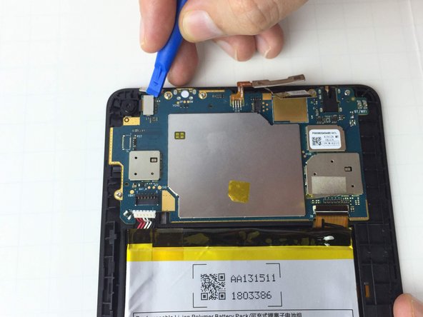

  7. Amazon Fire 5th Generation Rear Camera Replacement: crwdns2935265:09crwdnd2935265:01crwdnd2935265:03crwdne2935265:0 Amazon Fire 5th Generation Rear Camera Replacement: crwdns2935265:09crwdnd2935265:02crwdnd2935265:03crwdne2935265:0 Amazon Fire 5th Generation Rear Camera Replacement: crwdns2935265:09crwdnd2935265:03crwdnd2935265:03crwdne2935265:0
    • The rear facing camera wire connector must be disconnected in order to remove the motherboard.
    • To remove the rear facing wire connector, insert the iFixit Opening Tool beneath the connector and wedge it upwards.

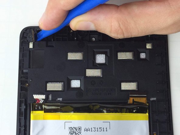

  9. Amazon Fire 5th Generation Rear Camera Replacement, Rear Camera: crwdns2935265:011crwdnd2935265:01crwdnd2935265:02crwdne2935265:0 Amazon Fire 5th Generation Rear Camera Replacement, Rear Camera: crwdns2935265:011crwdnd2935265:02crwdnd2935265:02crwdne2935265:0
    • The rear facing camera is directly attached with adhesive to the device case.
    • In order to remove the camera, use a plastic opening tool to wedge underneath and lift it out of its place.
