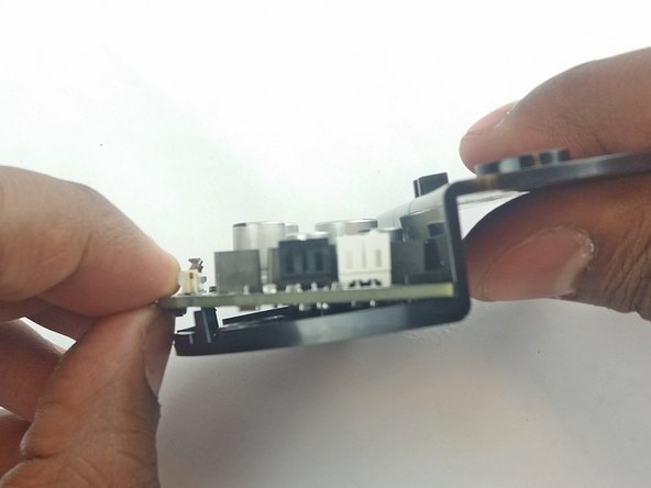

    6. Amazon Echo Woofer Replacement: crwdns2935265:06crwdnd2935265:01crwdnd2935265:03crwdne2935265:0 Amazon Echo Woofer Replacement: crwdns2935265:06crwdnd2935265:02crwdnd2935265:03crwdne2935265:0 Amazon Echo Woofer Replacement: crwdns2935265:06crwdnd2935265:03crwdnd2935265:03crwdne2935265:0
      • Using the spudger, pull back the two plastic clips on the plate.
      • Lift the board up and pull it away from the plate.

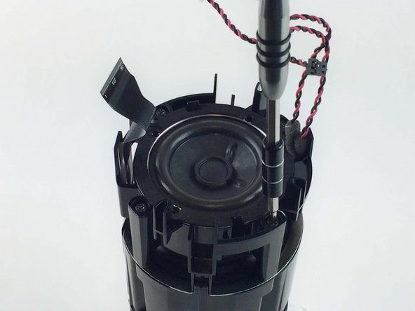

      • Remove the four 42.8 mm T10 Torx screws around the tweeter.
      • Lift the tweeter and its attached housing from the device.

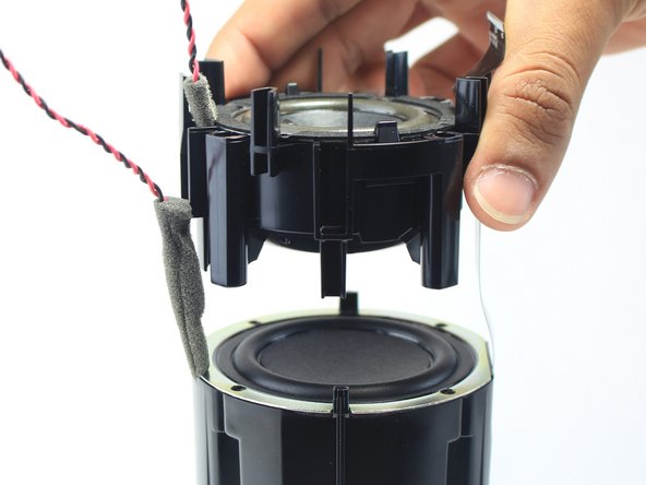

    1. Amazon Echo Woofer Replacement, Woofer: crwdns2935265:010crwdnd2935265:01crwdnd2935265:01crwdne2935265:0
      • Lift the woofer out of the Echo.
