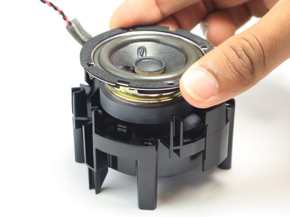

  10. Amazon Echo Tweeter Replacement, Tweeter: crwdns2935265:010crwdnd2935265:01crwdnd2935265:02crwdne2935265:0 Amazon Echo Tweeter Replacement, Tweeter: crwdns2935265:010crwdnd2935265:02crwdnd2935265:02crwdne2935265:0
    • Using a spudger or your fingers, pull back the plastic clips near the edge of the tweeter.
    • Remove the tweeter from its plastic housing.
