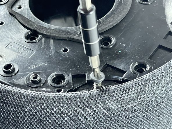

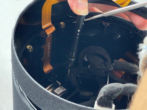

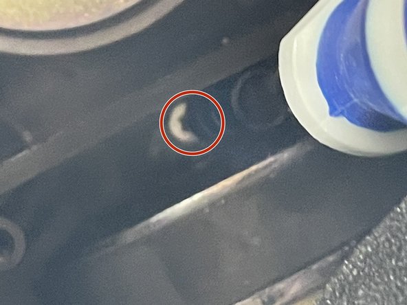

    • You will need to find and remove six 10mm screws to take off the top speaker's cover.
    • Unfortunately, it can be very risky to get these screws out without a thin, magnetic screwdriver, due to the minimal space between the frame and side speakers.

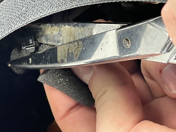

    • Before taking out the top speaker, first find and remove it's connector inside.
    • This connecter should have already been disconnected while removing the motherboard, but if it's still attached to the cable tie, you can just snip it in order to get the speaker out.
    • After snipping the tie, now pull the speaker out from the top.

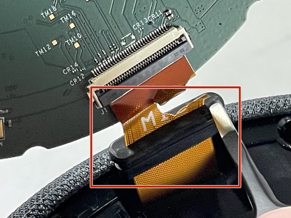

    • Unscrew and disconnect the lightboard.
    • Be careful not to break the connector; it is deceptively fragile.
