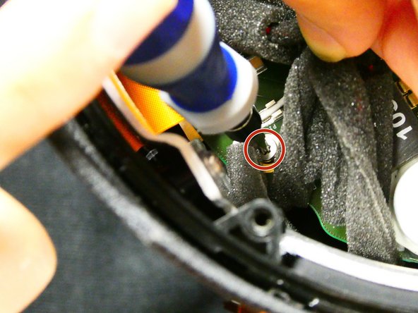

  8. Amazon Echo Studio Motherboard Replacement, Motherboard: crwdns2935265:08crwdnd2935265:01crwdnd2935265:02crwdne2935265:0 Amazon Echo Studio Motherboard Replacement, Motherboard: crwdns2935265:08crwdnd2935265:02crwdnd2935265:02crwdne2935265:0
    • Remove the thirteen 9 mm Phillips #00 screws.
    • Some screws may be hidden by other components; simply hold them out of your way during screw removal.
  9. Amazon Echo Studio Motherboard Replacement: crwdns2935265:09crwdnd2935265:01crwdnd2935265:01crwdne2935265:0
    • Unfasten the Phillips 9mm screws, using the Phillips #00 Screwdriver.
    • There may be obstruction against some screws, which can be avoided by using a spudger or your hand.
  10. Amazon Echo Studio Motherboard Replacement: crwdns2935265:010crwdnd2935265:01crwdnd2935265:03crwdne2935265:0 Amazon Echo Studio Motherboard Replacement: crwdns2935265:010crwdnd2935265:02crwdnd2935265:03crwdne2935265:0 Amazon Echo Studio Motherboard Replacement: crwdns2935265:010crwdnd2935265:03crwdnd2935265:03crwdne2935265:0
    • After removing the screws, locate the four power connectors on the motherboard and detach them from the motherboard.
  11. Amazon Echo Studio Motherboard Replacement: crwdns2935265:011crwdnd2935265:01crwdnd2935265:01crwdne2935265:0
    • Remove the motherboard from the device by pulling it out.
    • Be careful to not damage any of the loose wires inside the case while removing the motherboard.
