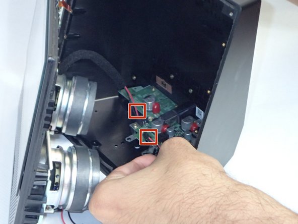

  4. Amazon Echo Show Speaker Replacement: crwdns2935265:04crwdnd2935265:01crwdnd2935265:02crwdne2935265:0 Amazon Echo Show Speaker Replacement: crwdns2935265:04crwdnd2935265:02crwdnd2935265:02crwdne2935265:0
    • Use tweezers or your hands to carefully disconnect the red wires connecting the speakers to the power supply board.
    • Repeat this step for the other speaker, and lay the front section flat with the facing down.
    • Make sure to ground yourself against a metal object nearby (ex. a metal chair, a door frame) before you touch any circuitry. An accidental static discharge can permanently damage a circuitboard.

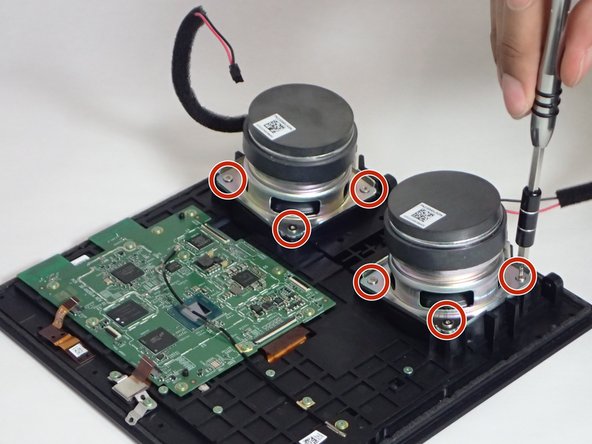

  5. Amazon Echo Show Speaker Replacement, Speaker: crwdns2935265:05crwdnd2935265:01crwdnd2935265:03crwdne2935265:0 Amazon Echo Show Speaker Replacement, Speaker: crwdns2935265:05crwdnd2935265:02crwdnd2935265:03crwdne2935265:0 Amazon Echo Show Speaker Replacement, Speaker: crwdns2935265:05crwdnd2935265:03crwdnd2935265:03crwdne2935265:0
    • Use a non-magnetic T-6 screwdriver to unscrew the four 6mm screws on the speaker mount.
    • Repeat this step for the other speaker.

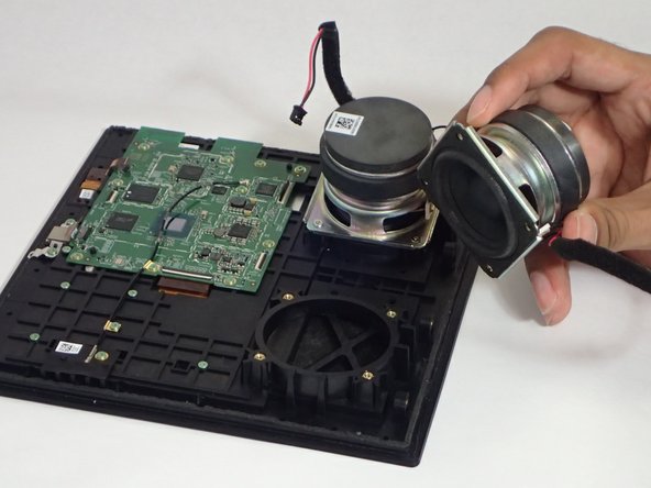

  6. Amazon Echo Show Speaker Replacement: crwdns2935265:06crwdnd2935265:01crwdnd2935265:02crwdne2935265:0 Amazon Echo Show Speaker Replacement: crwdns2935265:06crwdnd2935265:02crwdnd2935265:02crwdne2935265:0
    • Gently lift the speaker needing replacement from the device.
