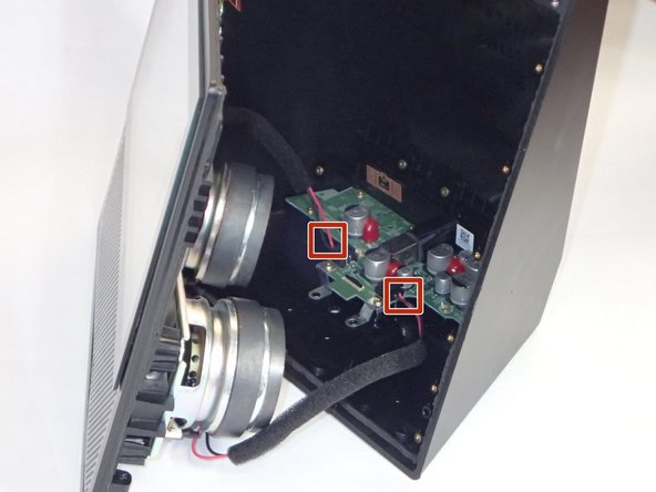

    3. Amazon Echo Show Motherboard Replacement: crwdns2935265:03crwdnd2935265:01crwdnd2935265:03crwdne2935265:0 Amazon Echo Show Motherboard Replacement: crwdns2935265:03crwdnd2935265:02crwdnd2935265:03crwdne2935265:0 Amazon Echo Show Motherboard Replacement: crwdns2935265:03crwdnd2935265:03crwdnd2935265:03crwdne2935265:0
      • After the screws are removed, grip the front panel and separate the front from the back. This will expose the inside of the device.
      • Use tweezers or your hands to carefully disconnect the red wires connecting the speakers to the power supply board.
      • Visually locate the motherboard within the device. It is the large green panel right above the speakers.

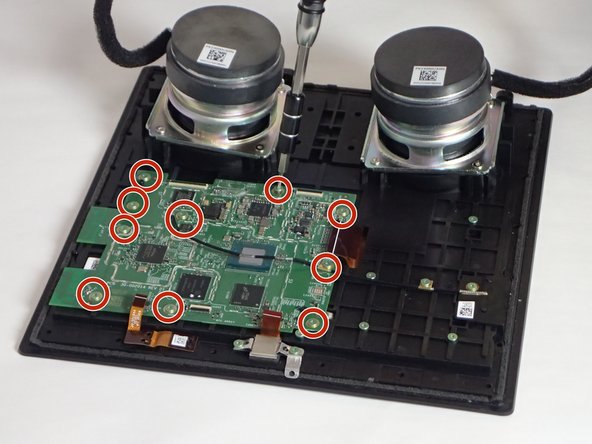

    4. Amazon Echo Show Motherboard Replacement: crwdns2935265:04crwdnd2935265:01crwdnd2935265:02crwdne2935265:0 Amazon Echo Show Motherboard Replacement: crwdns2935265:04crwdnd2935265:02crwdnd2935265:02crwdne2935265:0
      • Unscrew the ten 1mm T5 Torx screws holding the motherboard in place.

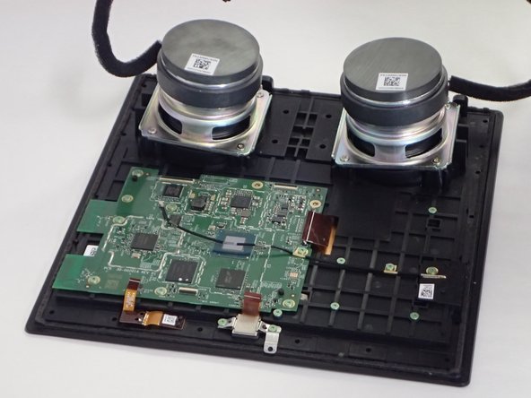

    6. Amazon Echo Show Motherboard Replacement: crwdns2935265:06crwdnd2935265:01crwdnd2935265:01crwdne2935265:0
      • Once all the screws have been removed, you should be able to gently lift the motherboard up and out of the device.
To reassemble your device, follow these instructions in reverse order. Make sure that the ring on the black wire is attached between the circuit board and the screw, and that the black tape on the end is lined up as well.
