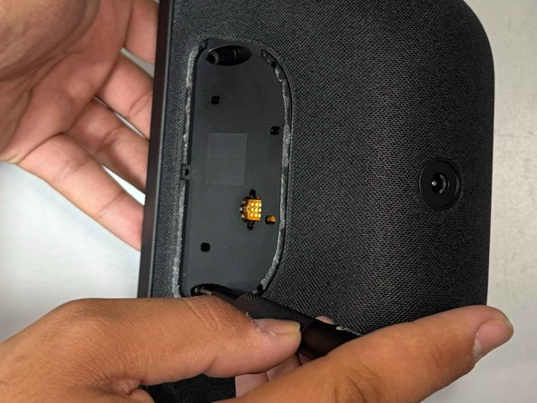

    • Use a prying tool to remove the rubber foot at the bottom.
    • It is secured with adhesive and will lift off with some gentle prying.
    • Use an opening pick to remove the screw cover.

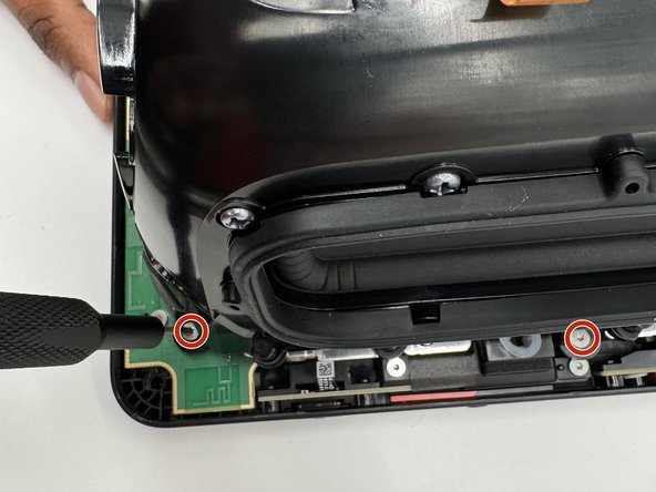

    • Use a Torx TR8 screwdriver to remove the two 2 cm screws.
  3. Amazon Echo Show 8 3rd Gen Motherboard Replacement: crwdns2935265:03crwdnd2935265:01crwdnd2935265:02crwdne2935265:0 Amazon Echo Show 8 3rd Gen Motherboard Replacement: crwdns2935265:03crwdnd2935265:02crwdnd2935265:02crwdne2935265:0
    • Insert a jimmy in the gap between the display and chassis.
    • Pry around the perimeter until the back case releases.
    • Be careful as to not damage the ribbon cable on the top left area of the screen.
    • Remove the back case.

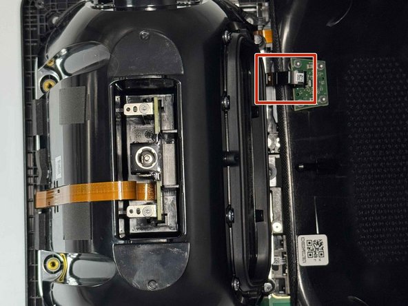

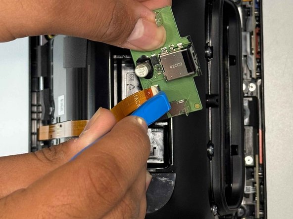

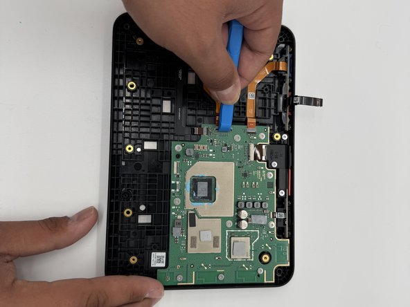

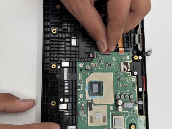

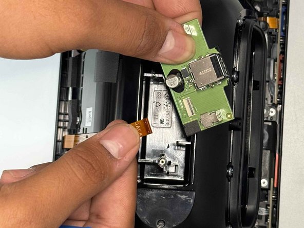

  4. Amazon Echo Show 8 3rd Gen Motherboard Replacement: crwdns2935265:04crwdnd2935265:01crwdnd2935265:03crwdne2935265:0 Amazon Echo Show 8 3rd Gen Motherboard Replacement: crwdns2935265:04crwdnd2935265:02crwdnd2935265:03crwdne2935265:0 Amazon Echo Show 8 3rd Gen Motherboard Replacement: crwdns2935265:04crwdnd2935265:03crwdnd2935265:03crwdne2935265:0
    • Use a Torx TR6 screwdriver to remove the two 5 mm screws that secure the power board.
    • Carefully lift the board without straining the ribbon cable.
    • Using an opening tool, carefully flip up the black ZIF locking flap that secures the ribbon cable.
    • Disconnect the ribbon cable.

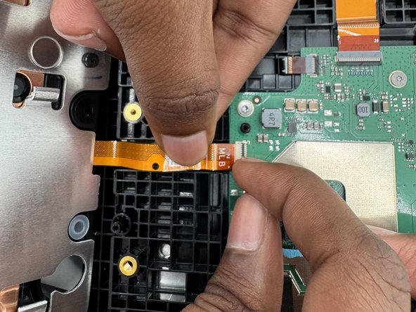

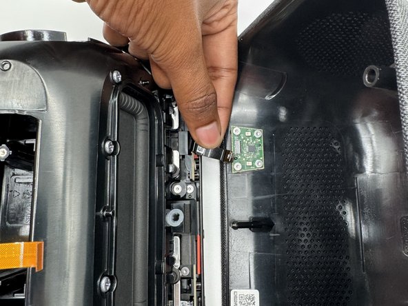

  5. Amazon Echo Show 8 3rd Gen Motherboard Replacement, Speakers: crwdns2935265:05crwdnd2935265:01crwdnd2935265:03crwdne2935265:0 Amazon Echo Show 8 3rd Gen Motherboard Replacement, Speakers: crwdns2935265:05crwdnd2935265:02crwdnd2935265:03crwdne2935265:0 Amazon Echo Show 8 3rd Gen Motherboard Replacement, Speakers: crwdns2935265:05crwdnd2935265:03crwdnd2935265:03crwdne2935265:0
    • Gently tilt the shell towards the top of the device and disconnect the ribbon cable from the board on the case.
    • Don't tilt the cable too much as you can damage the ribbon or the connector.

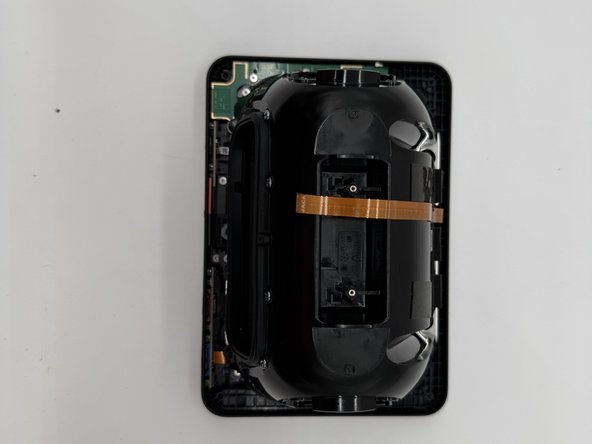

  6. Amazon Echo Show 8 3rd Gen Motherboard Replacement: crwdns2935265:06crwdnd2935265:01crwdnd2935265:03crwdne2935265:0 Amazon Echo Show 8 3rd Gen Motherboard Replacement: crwdns2935265:06crwdnd2935265:02crwdnd2935265:03crwdne2935265:0 Amazon Echo Show 8 3rd Gen Motherboard Replacement: crwdns2935265:06crwdnd2935265:03crwdnd2935265:03crwdne2935265:0
    • Use a TR6 screwdriver to remove the six 7mm screws located around the speaker assembly.
    • Gently tilt the speaker assembly towards the ribbon cable.
    • The ribbon cable is fragile and can be damaged if moved any other way.
    • Flip open the black tab on the connector towards the cable and gently pull.
    • Don't use too much force pulling up on the tab, as it can break and the cable will no longer be properly connected.

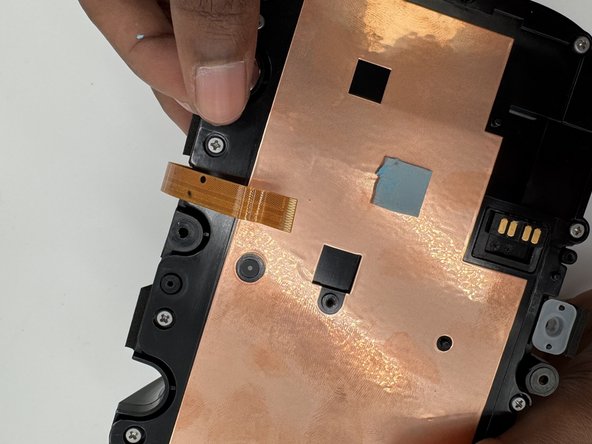

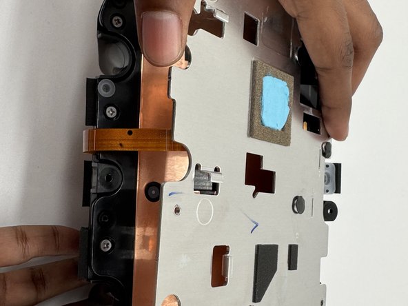

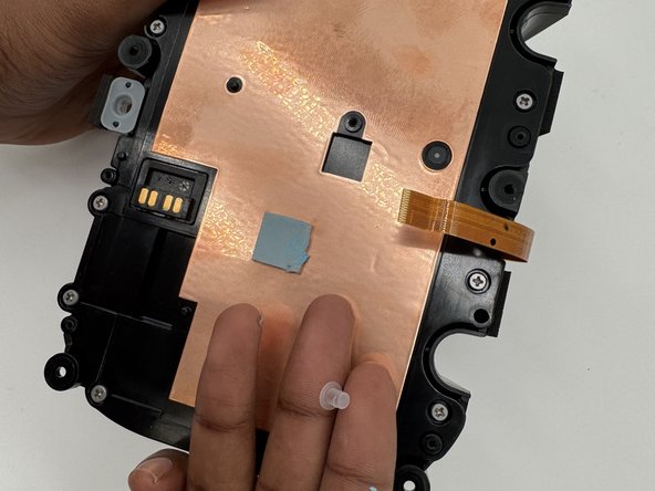

  7. Amazon Echo Show 8 3rd Gen Motherboard Replacement: crwdns2935265:07crwdnd2935265:01crwdnd2935265:03crwdne2935265:0 Amazon Echo Show 8 3rd Gen Motherboard Replacement: crwdns2935265:07crwdnd2935265:02crwdnd2935265:03crwdne2935265:0 Amazon Echo Show 8 3rd Gen Motherboard Replacement: crwdns2935265:07crwdnd2935265:03crwdnd2935265:03crwdne2935265:0
    • Use a TR6 Torx screwdriver to remove the eight 9 mm screws holding the metal bracket.
    • Gently lift off the metal bracket.

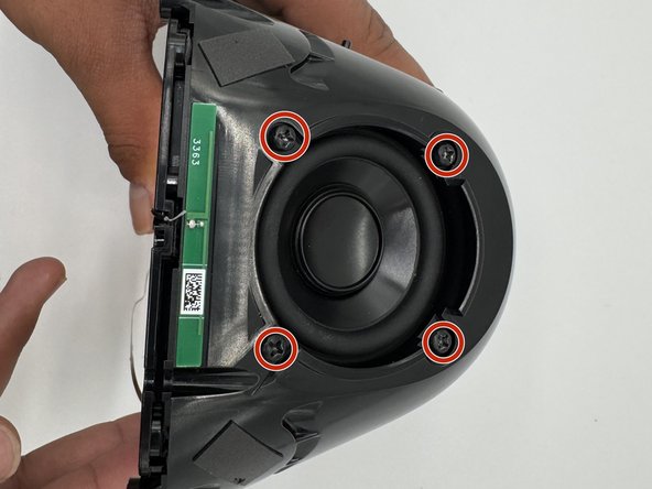

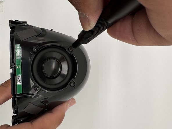

  9. Amazon Echo Show 8 3rd Gen Motherboard Replacement: crwdns2935265:09crwdnd2935265:01crwdnd2935265:03crwdne2935265:0 Amazon Echo Show 8 3rd Gen Motherboard Replacement: crwdns2935265:09crwdnd2935265:02crwdnd2935265:03crwdne2935265:0 Amazon Echo Show 8 3rd Gen Motherboard Replacement: crwdns2935265:09crwdnd2935265:03crwdnd2935265:03crwdne2935265:0
    • Use a Phillips #1 screwdriver to remove the four 1.3 cm screws holding down each driver.
    • Gently pull the plastic plate towards the antenna cable.
    • There is a small antenna cable that is easy to rip off the solder joint, so lift carefully.
    • There are 8 screws on the long side of the housing, but there is no driver behind it, so you don't need to remove them.

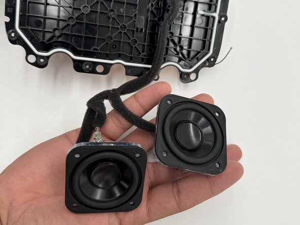

  10. Amazon Echo Show 8 3rd Gen Motherboard Replacement: crwdns2935265:010crwdnd2935265:01crwdnd2935265:02crwdne2935265:0 Amazon Echo Show 8 3rd Gen Motherboard Replacement: crwdns2935265:010crwdnd2935265:02crwdnd2935265:02crwdne2935265:0
    • Pry the speakers from the housing with a spudger.
    • The speakers are connected to a spring-loaded pin connector which is attached to the black plastic using industrial hot glue, so while you can heat the glue to remove it, the plastic may melt and/or deform, so we wouldn't recommend it.

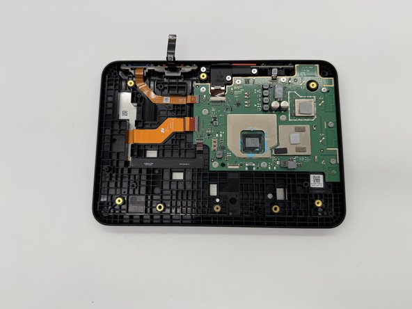

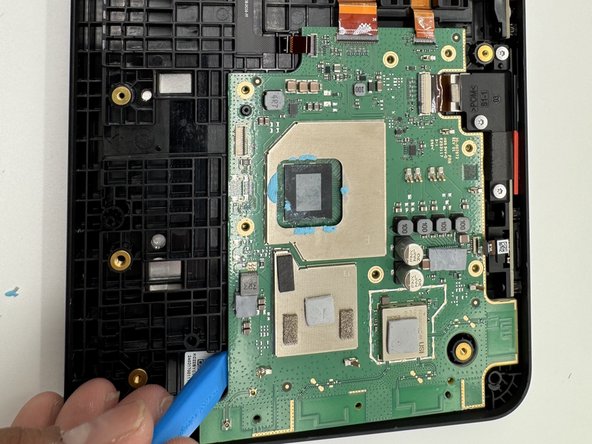

  11. Amazon Echo Show 8 3rd Gen Motherboard Replacement, Motherboard: crwdns2935265:011crwdnd2935265:01crwdnd2935265:03crwdne2935265:0 Amazon Echo Show 8 3rd Gen Motherboard Replacement, Motherboard: crwdns2935265:011crwdnd2935265:02crwdnd2935265:03crwdne2935265:0 Amazon Echo Show 8 3rd Gen Motherboard Replacement, Motherboard: crwdns2935265:011crwdnd2935265:03crwdnd2935265:03crwdne2935265:0
    • Use an opening tool to flip up the black ZIF locking flap that secure the four ribbon cables.
  12. Amazon Echo Show 8 3rd Gen Motherboard Replacement: crwdns2935265:012crwdnd2935265:01crwdnd2935265:02crwdne2935265:0 Amazon Echo Show 8 3rd Gen Motherboard Replacement: crwdns2935265:012crwdnd2935265:02crwdnd2935265:02crwdne2935265:0
    • Use angled tweezers to disconnect all the ribbon cables from their motherboard sockets.
    • The ribbon cables are fragile; pull with care.

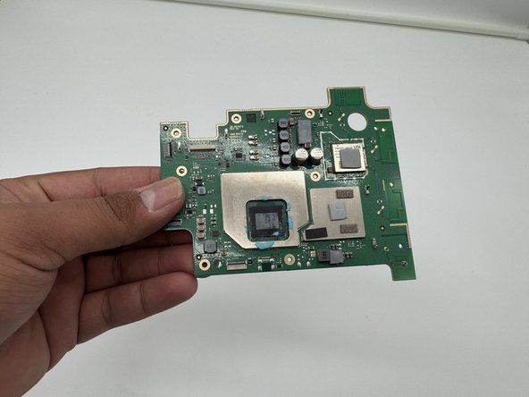

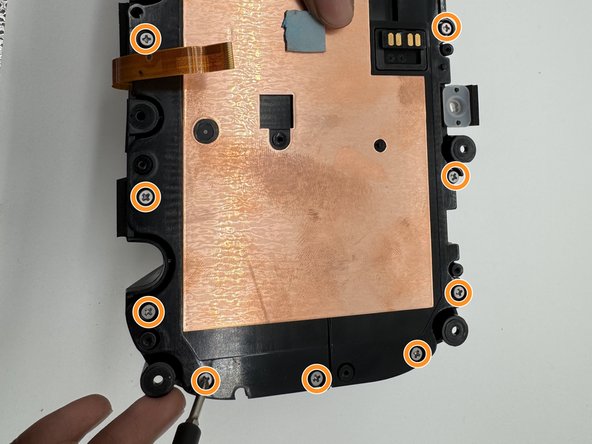

  13. Amazon Echo Show 8 3rd Gen Motherboard Replacement: crwdns2935265:013crwdnd2935265:01crwdnd2935265:03crwdne2935265:0 Amazon Echo Show 8 3rd Gen Motherboard Replacement: crwdns2935265:013crwdnd2935265:02crwdnd2935265:03crwdne2935265:0 Amazon Echo Show 8 3rd Gen Motherboard Replacement: crwdns2935265:013crwdnd2935265:03crwdnd2935265:03crwdne2935265:0
    • Remove all 10 5 mm screws on the motherboard using a TR6 Torx screwdriver.
