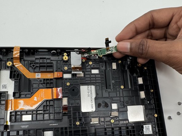

  4. Amazon Echo Show 8 3rd Gen Display Assembly Replacement: crwdns2935265:04crwdnd2935265:01crwdnd2935265:03crwdne2935265:0 Amazon Echo Show 8 3rd Gen Display Assembly Replacement: crwdns2935265:04crwdnd2935265:02crwdnd2935265:03crwdne2935265:0 Amazon Echo Show 8 3rd Gen Display Assembly Replacement: crwdns2935265:04crwdnd2935265:03crwdnd2935265:03crwdne2935265:0
    • Use a Torx TR6 screwdriver to remove the two 5 mm screws that secure the power board.
    • Carefully lift the board without straining the ribbon cable.
    • Using an opening tool, carefully flip up the black ZIF locking flap that secures the ribbon cable.
    • Disconnect the ribbon cable.

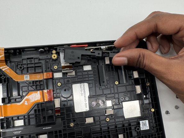

  7. Amazon Echo Show 8 3rd Gen Display Assembly Replacement: crwdns2935265:07crwdnd2935265:01crwdnd2935265:03crwdne2935265:0 Amazon Echo Show 8 3rd Gen Display Assembly Replacement: crwdns2935265:07crwdnd2935265:02crwdnd2935265:03crwdne2935265:0 Amazon Echo Show 8 3rd Gen Display Assembly Replacement: crwdns2935265:07crwdnd2935265:03crwdnd2935265:03crwdne2935265:0
    • Use a TR6 Torx screwdriver to remove the eight 9 mm screws holding the metal bracket.
    • Gently lift off the metal bracket.

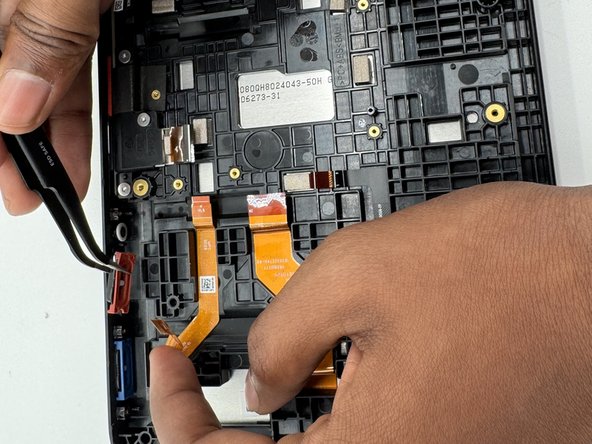

  11. Amazon Echo Show 8 3rd Gen Display Assembly Replacement, Motherboard: crwdns2935265:011crwdnd2935265:01crwdnd2935265:03crwdne2935265:0 Amazon Echo Show 8 3rd Gen Display Assembly Replacement, Motherboard: crwdns2935265:011crwdnd2935265:02crwdnd2935265:03crwdne2935265:0 Amazon Echo Show 8 3rd Gen Display Assembly Replacement, Motherboard: crwdns2935265:011crwdnd2935265:03crwdnd2935265:03crwdne2935265:0
    • Use an opening tool to flip up the black ZIF locking flap that secure the four ribbon cables.
  12. Amazon Echo Show 8 3rd Gen Display Assembly Replacement: crwdns2935265:012crwdnd2935265:01crwdnd2935265:02crwdne2935265:0 Amazon Echo Show 8 3rd Gen Display Assembly Replacement: crwdns2935265:012crwdnd2935265:02crwdnd2935265:02crwdne2935265:0
    • Use angled tweezers to disconnect all the ribbon cables from their motherboard sockets.
    • The ribbon cables are fragile; pull with care.

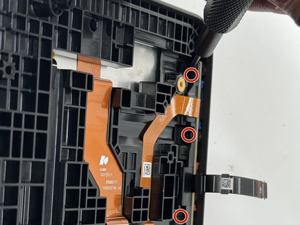

  14. Amazon Echo Show 8 3rd Gen Display Assembly Replacement, Volume Buttons: crwdns2935265:014crwdnd2935265:01crwdnd2935265:03crwdne2935265:0 Amazon Echo Show 8 3rd Gen Display Assembly Replacement, Volume Buttons: crwdns2935265:014crwdnd2935265:02crwdnd2935265:03crwdne2935265:0 Amazon Echo Show 8 3rd Gen Display Assembly Replacement, Volume Buttons: crwdns2935265:014crwdnd2935265:03crwdnd2935265:03crwdne2935265:0
    • Remove the three 6 mm screws that secure the board using a TR4 Torx screwdriver.
  15. Amazon Echo Show 8 3rd Gen Display Assembly Replacement: crwdns2935265:015crwdnd2935265:01crwdnd2935265:03crwdne2935265:0 Amazon Echo Show 8 3rd Gen Display Assembly Replacement: crwdns2935265:015crwdnd2935265:02crwdnd2935265:03crwdne2935265:0 Amazon Echo Show 8 3rd Gen Display Assembly Replacement: crwdns2935265:015crwdnd2935265:03crwdnd2935265:03crwdne2935265:0

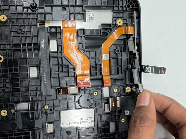

    • Use an opening tool to flip open the black ZIF locking flap that secures the ribbon cable.
    • Be gentle with the ribbon cable.
    • Use tweezers to remove both buttons from the case.

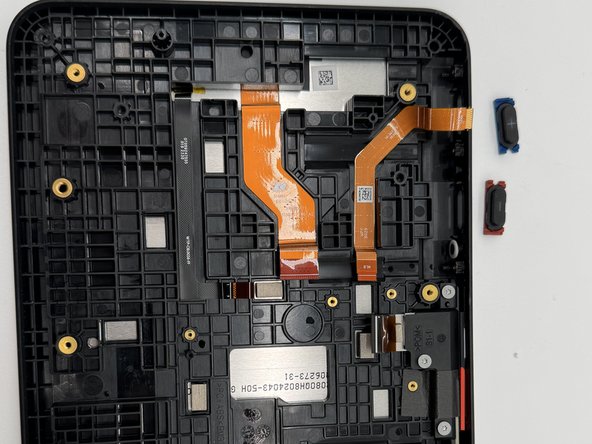

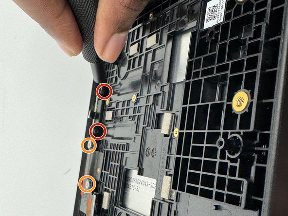

  16. Amazon Echo Show 8 3rd Gen Display Assembly Replacement, Display Assembly: crwdns2935265:016crwdnd2935265:01crwdnd2935265:02crwdne2935265:0 Amazon Echo Show 8 3rd Gen Display Assembly Replacement, Display Assembly: crwdns2935265:016crwdnd2935265:02crwdnd2935265:02crwdne2935265:0
    • Remove the three 6 mm screws with a TR4 Torx screwdriver; remove the top buttons.
    • Remove the two 7 mm screws with a TR6 Torx screwdriver; remove the camera.
  17. Amazon Echo Show 8 3rd Gen Display Assembly Replacement: crwdns2935265:017crwdnd2935265:01crwdnd2935265:03crwdne2935265:0 Amazon Echo Show 8 3rd Gen Display Assembly Replacement: crwdns2935265:017crwdnd2935265:02crwdnd2935265:03crwdne2935265:0 Amazon Echo Show 8 3rd Gen Display Assembly Replacement: crwdns2935265:017crwdnd2935265:03crwdnd2935265:03crwdne2935265:0
    • Remove the plastic cover.
    • Remove the button and camera.
