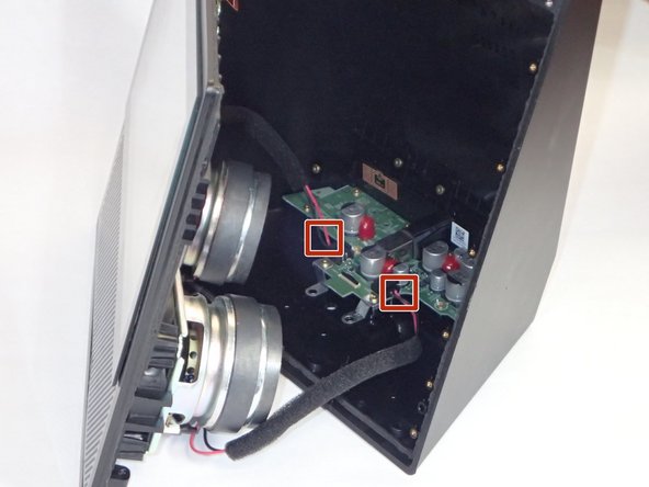

      • After the screws are removed, grip the front panel and separate the front from the back. This will expose the inside of the device.
      • Make sure to ground yourself against a metal object nearby (ex. a metal chair, a door frame) before you touch any circuitry. An accidental static discharge can permanently damage a circuitboard.
      • Use tweezers or your hands to carefully disconnect the red wires connecting the speakers to the power supply board.

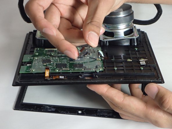

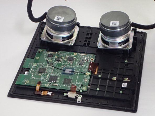

      • Lay the front section flat, with the screen down.
    5. Amazon Echo Show 5-Megapixel Camera  Replacement: crwdns2935265:05crwdnd2935265:01crwdnd2935265:03crwdne2935265:0 Amazon Echo Show 5-Megapixel Camera  Replacement: crwdns2935265:05crwdnd2935265:02crwdnd2935265:03crwdne2935265:0 Amazon Echo Show 5-Megapixel Camera  Replacement: crwdns2935265:05crwdnd2935265:03crwdnd2935265:03crwdne2935265:0

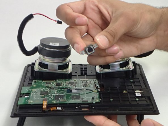

      • Remove two 1mm T5 Torx screws.
      • Once the screws have been removed, you can easily remove the camera from the device.
