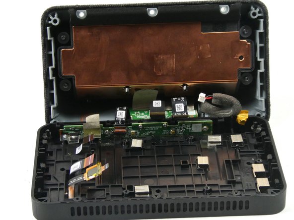

  4. Amazon Echo Show 5 Motherboard Replacement: crwdns2935265:04crwdnd2935265:01crwdnd2935265:01crwdne2935265:0
    • Carefully open the device by folding it open along the top edge where the camera is located.
    • Do not try to open the device from any other side as this would damage the ribbon connectors.
  5. Amazon Echo Show 5 Motherboard Replacement, Motherboard: crwdns2935265:05crwdnd2935265:01crwdnd2935265:01crwdne2935265:0
    • Remove the red and black power connector connecting to the motherboard with either a prying tool or your hands.

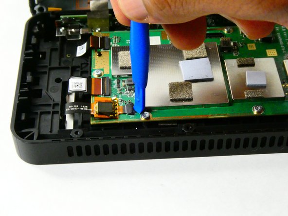

  6. Amazon Echo Show 5 Motherboard Replacement: crwdns2935265:06crwdnd2935265:01crwdnd2935265:02crwdne2935265:0 Amazon Echo Show 5 Motherboard Replacement: crwdns2935265:06crwdnd2935265:02crwdnd2935265:02crwdne2935265:0
    • Disconnect the five ribbon cables connecting to the motherboard.
    • To disconnect the cables, use the tip of a prying tool, or your fingernail, to flip up the small locking flap. Then, you can safely pull the cable out.
    • Be sure to pry up the hinged flap, not the connector socket.
    • There is a white line on the ribbon connectors that indicates the edge of the connection area. To reinstall, insert the connector up to this white line and close the flap. If the white line is clearly visible after closing the flap, it is probably misaligned and needs to be repositioned.
  7. Amazon Echo Show 5 Motherboard Replacement: crwdns2935265:07crwdnd2935265:01crwdnd2935265:01crwdne2935265:0
    • Remove the six 4 mm screws that are used to hold down the motherboard using a T6 Security Torx Screwdriver.
  8. Amazon Echo Show 5 Motherboard Replacement: crwdns2935265:08crwdnd2935265:01crwdnd2935265:02crwdne2935265:0 Amazon Echo Show 5 Motherboard Replacement: crwdns2935265:08crwdnd2935265:02crwdnd2935265:02crwdne2935265:0
    • Lift the motherboard up and out.
