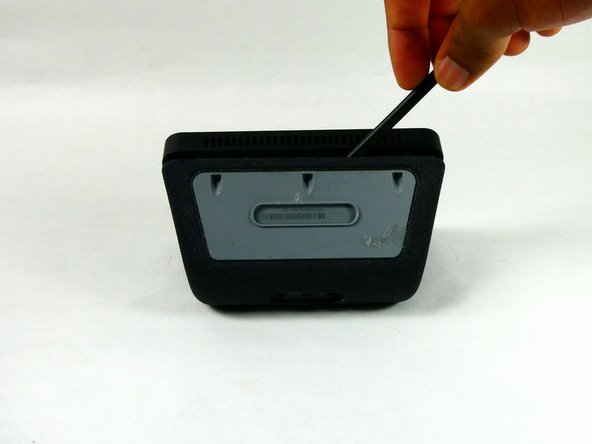

    • Power off and unplug the Amazon Echo Show 5. Failure to do so could result in injury or damage to the device.
    • Orient the Amazon Echo Show 5 so that the display is face down.
    • Use a spudger to remove the grey bottom cover.
    • During reassembly, adhesive needs to be applied to secure the bottom cover.

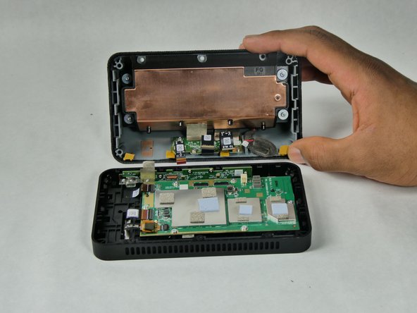

  4. Amazon Echo Show 5 I/O Board Replacement: crwdns2935265:04crwdnd2935265:01crwdnd2935265:01crwdne2935265:0
    • Carefully open the device by folding it open along the top edge where the camera is located.
    • Do not try to open the device from any other side as this would damage the ribbon connectors.

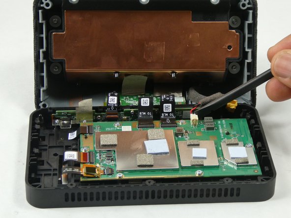

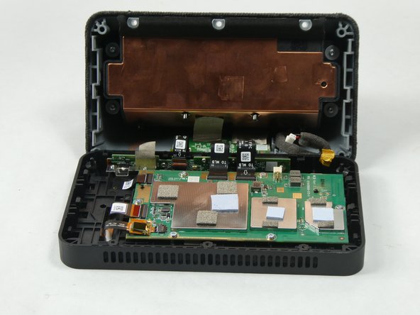

  5. Amazon Echo Show 5 I/O Board Replacement, Speaker: crwdns2935265:05crwdnd2935265:01crwdnd2935265:03crwdne2935265:0 Amazon Echo Show 5 I/O Board Replacement, Speaker: crwdns2935265:05crwdnd2935265:02crwdnd2935265:03crwdne2935265:0 Amazon Echo Show 5 I/O Board Replacement, Speaker: crwdns2935265:05crwdnd2935265:03crwdnd2935265:03crwdne2935265:0
    • Carefully disconnect the red and black power connector.

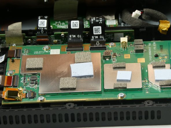

  6. Amazon Echo Show 5 I/O Board Replacement: crwdns2935265:06crwdnd2935265:01crwdnd2935265:03crwdne2935265:0 Amazon Echo Show 5 I/O Board Replacement: crwdns2935265:06crwdnd2935265:02crwdnd2935265:03crwdne2935265:0 Amazon Echo Show 5 I/O Board Replacement: crwdns2935265:06crwdnd2935265:03crwdnd2935265:03crwdne2935265:0
    • Remove the three ZIF connector ribbon cables that connect the speaker housing to the display housing.
    • Do not pull ribbon cables straight out, as this will damage the device. To safely remove ribbon cables, pull up on the tab where the cable is going into.

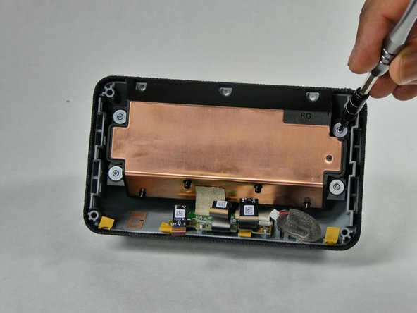

  7. Amazon Echo Show 5 I/O Board Replacement: crwdns2935265:07crwdnd2935265:01crwdnd2935265:03crwdne2935265:0 Amazon Echo Show 5 I/O Board Replacement: crwdns2935265:07crwdnd2935265:02crwdnd2935265:03crwdne2935265:0 Amazon Echo Show 5 I/O Board Replacement: crwdns2935265:07crwdnd2935265:03crwdnd2935265:03crwdne2935265:0
    • Remove the four screws securing the speaker using a T6 Torx screwdriver.

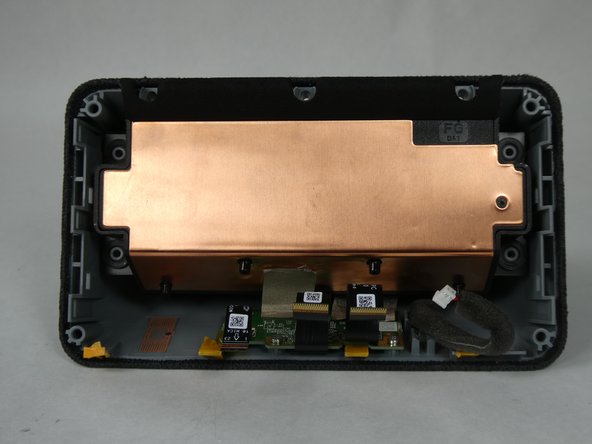

  8. Amazon Echo Show 5 I/O Board Replacement: crwdns2935265:08crwdnd2935265:01crwdnd2935265:03crwdne2935265:0 Amazon Echo Show 5 I/O Board Replacement: crwdns2935265:08crwdnd2935265:02crwdnd2935265:03crwdne2935265:0 Amazon Echo Show 5 I/O Board Replacement: crwdns2935265:08crwdnd2935265:03crwdnd2935265:03crwdne2935265:0
    • Pull back the silver tape.
  9. Amazon Echo Show 5 I/O Board Replacement: crwdns2935265:09crwdnd2935265:01crwdnd2935265:01crwdne2935265:0
    • Carefully pull out the speaker housing from the black ledge.

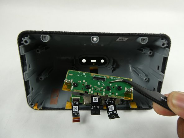

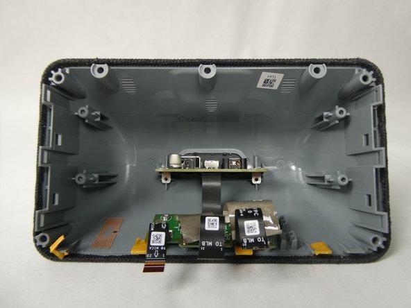

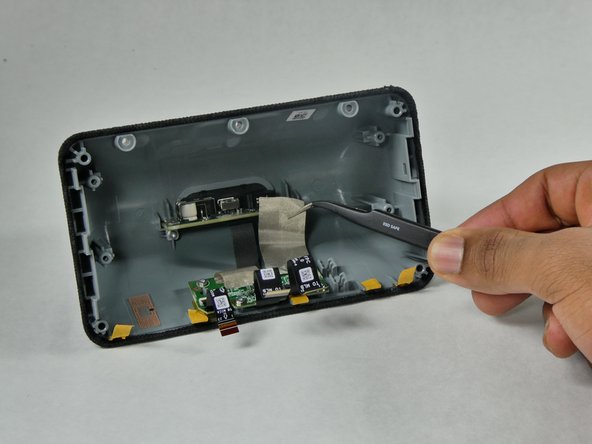

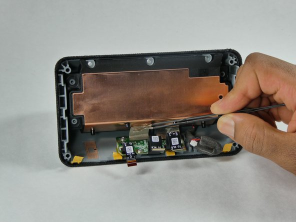

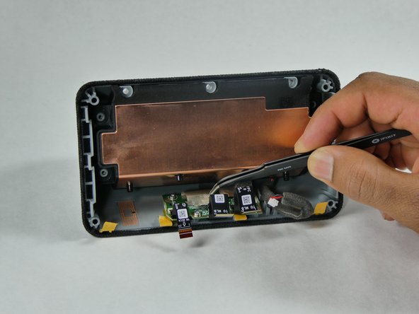

  10. Amazon Echo Show 5 I/O Board Replacement, I/O Board: crwdns2935265:010crwdnd2935265:01crwdnd2935265:03crwdne2935265:0 Amazon Echo Show 5 I/O Board Replacement, I/O Board: crwdns2935265:010crwdnd2935265:02crwdnd2935265:03crwdne2935265:0 Amazon Echo Show 5 I/O Board Replacement, I/O Board: crwdns2935265:010crwdnd2935265:03crwdnd2935265:03crwdne2935265:0
    • Use tweezers to peel off the metallic tape from the I/O board.

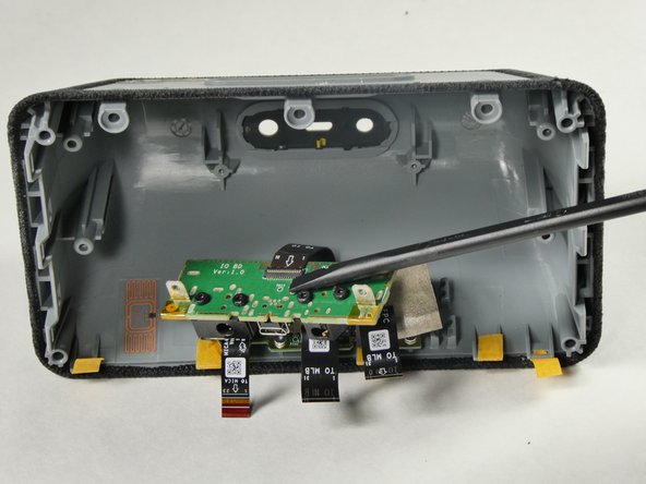

  11. Amazon Echo Show 5 I/O Board Replacement: crwdns2935265:011crwdnd2935265:01crwdnd2935265:03crwdne2935265:0 Amazon Echo Show 5 I/O Board Replacement: crwdns2935265:011crwdnd2935265:02crwdnd2935265:03crwdne2935265:0 Amazon Echo Show 5 I/O Board Replacement: crwdns2935265:011crwdnd2935265:03crwdnd2935265:03crwdne2935265:0
    • Use the T6 Torx screwdriver to remove the two screws.

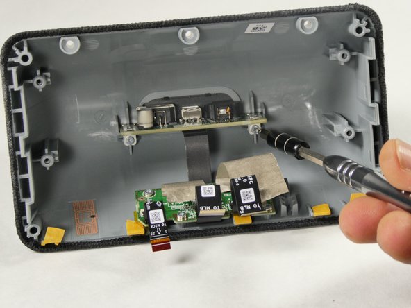

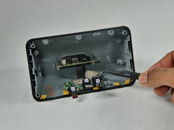

  12. Amazon Echo Show 5 I/O Board Replacement: crwdns2935265:012crwdnd2935265:01crwdnd2935265:02crwdne2935265:0 Amazon Echo Show 5 I/O Board Replacement: crwdns2935265:012crwdnd2935265:02crwdnd2935265:02crwdne2935265:0
    • Lift the board so that the ribbon cable is easily accessible.
    • Try not to use too much force as this may damage the ribbon cable.
  13. Amazon Echo Show 5 I/O Board Replacement: crwdns2935265:013crwdnd2935265:01crwdnd2935265:02crwdne2935265:0 Amazon Echo Show 5 I/O Board Replacement: crwdns2935265:013crwdnd2935265:02crwdnd2935265:02crwdne2935265:0
    • Disconnect the single ribbon cable.
    • Carefully pull out the I/O board.
