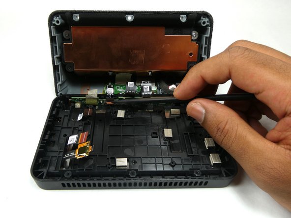

  3. Amazon Echo Show 5 Camera Replacement: crwdns2935265:03crwdnd2935265:01crwdnd2935265:03crwdne2935265:0 Amazon Echo Show 5 Camera Replacement: crwdns2935265:03crwdnd2935265:02crwdnd2935265:03crwdne2935265:0 Amazon Echo Show 5 Camera Replacement: crwdns2935265:03crwdnd2935265:03crwdnd2935265:03crwdne2935265:0
    • Use a spudger to release the six internal tabs lining the sides of the device.
    • There are fragile ribbon connectors along the side of the screen with the camera on it. So, do not stick the spudger more than a couple millimeters into the device.

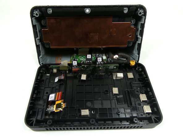

  4. Amazon Echo Show 5 Camera Replacement: crwdns2935265:04crwdnd2935265:01crwdnd2935265:01crwdne2935265:0
    • Carefully open the device by folding it open along the top edge where the camera is located.
    • Do not try to open the device from any other side as this would damage the ribbon connectors.

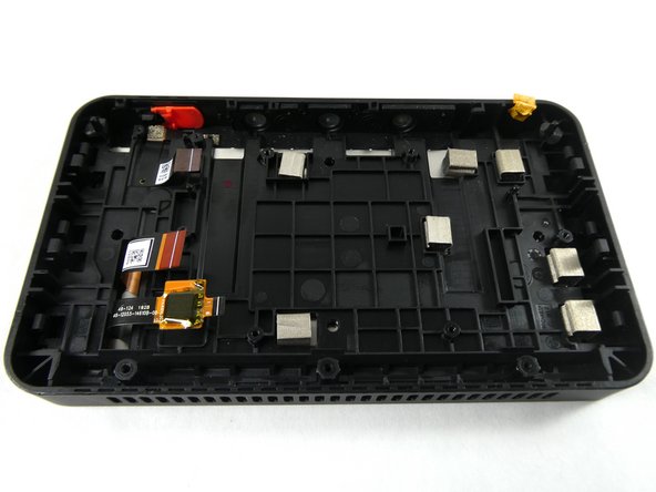

  11. Amazon Echo Show 5 Camera Replacement: crwdns2935265:011crwdnd2935265:01crwdnd2935265:03crwdne2935265:0 Amazon Echo Show 5 Camera Replacement: crwdns2935265:011crwdnd2935265:02crwdnd2935265:03crwdne2935265:0 Amazon Echo Show 5 Camera Replacement: crwdns2935265:011crwdnd2935265:03crwdnd2935265:03crwdne2935265:0
    • Use the Philips #000 Screwdriver to remove the four 4 mm screws that attach the microphone board to the case.
  12. Amazon Echo Show 5 Camera Replacement: crwdns2935265:012crwdnd2935265:01crwdnd2935265:02crwdne2935265:0 Amazon Echo Show 5 Camera Replacement: crwdns2935265:012crwdnd2935265:02crwdnd2935265:02crwdne2935265:0
    • Use a tweezer to remove the microphone board from the case.

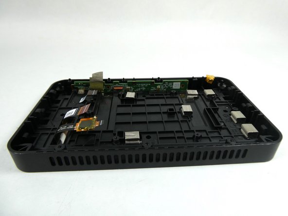

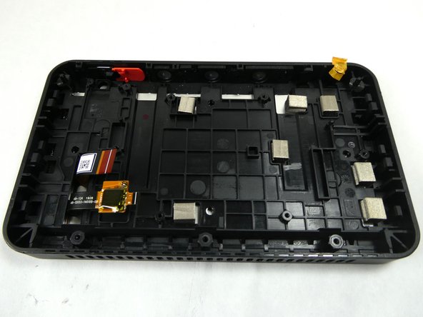

  13. Amazon Echo Show 5 Camera Replacement, Camera: crwdns2935265:013crwdnd2935265:01crwdnd2935265:02crwdne2935265:0 Amazon Echo Show 5 Camera Replacement, Camera: crwdns2935265:013crwdnd2935265:02crwdnd2935265:02crwdne2935265:0
    • Use tweezers to remove the camera from the display assembly.
    • The camera has adhesive on the ribbon connector which needs to be reapplied in order to reassemble it.
    • The ribbon connector attached to the camera is very fragile. Avoid bending or kinking the connector as this will cause damage to the device.
