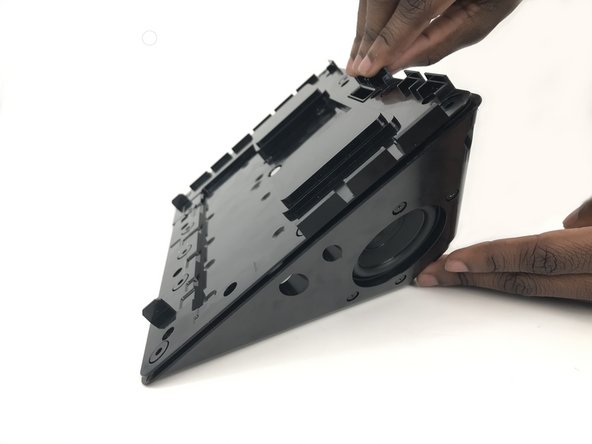

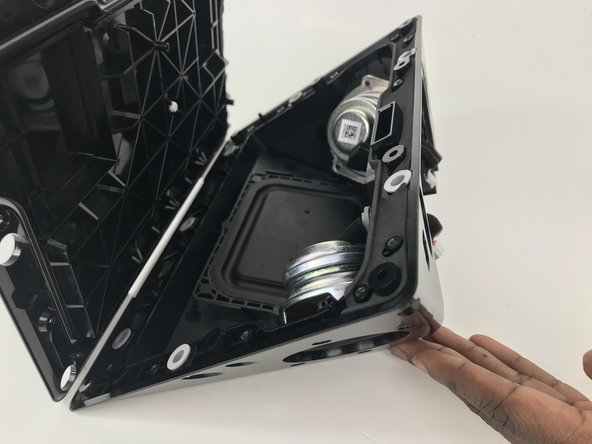

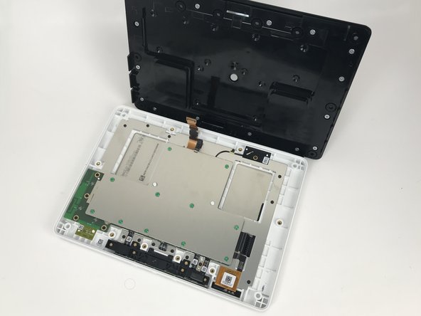

  5. Amazon Echo Show 2nd Gen Speaker Replacement, Speakers: crwdns2935265:05crwdnd2935265:01crwdnd2935265:03crwdne2935265:0 Amazon Echo Show 2nd Gen Speaker Replacement, Speakers: crwdns2935265:05crwdnd2935265:02crwdnd2935265:03crwdne2935265:0 Amazon Echo Show 2nd Gen Speaker Replacement, Speakers: crwdns2935265:05crwdnd2935265:03crwdnd2935265:03crwdne2935265:0
    • Firmly grasp the white trim of the front piece with one hand while the other pulls back on the black back portion of the device.

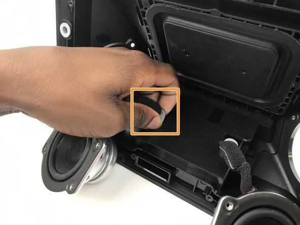

  7. Amazon Echo Show 2nd Gen Speaker Replacement: crwdns2935265:07crwdnd2935265:01crwdnd2935265:03crwdne2935265:0 Amazon Echo Show 2nd Gen Speaker Replacement: crwdns2935265:07crwdnd2935265:02crwdnd2935265:03crwdne2935265:0 Amazon Echo Show 2nd Gen Speaker Replacement: crwdns2935265:07crwdnd2935265:03crwdnd2935265:03crwdne2935265:0
    • After unscrewing the speakers, gently pull out the foam covered attachment indicated in the orange box.

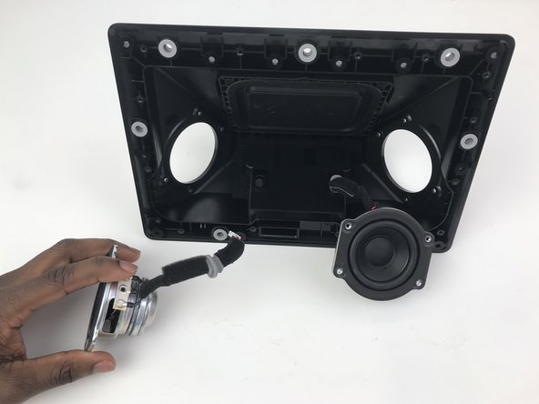

  8. Amazon Echo Show 2nd Gen Speaker Replacement: crwdns2935265:08crwdnd2935265:01crwdnd2935265:01crwdne2935265:0
    • Insert the white circuit box into the back plate the old speaker was removed from as indicated in he orange box.
    • Repeat on the other speaker if needed.

These instructions are missing one important step, at least on my version of the Echo Show 10 2nd gen. There are 8 Tr8 screws holding the big black backside with the speakers + sound card in place 4 at the top, 2 on each side and 2 at the bottom. Note the 2 screws at the bottom are behind the white cover removed in step 1.
These 8 screws need to be removed before separating the back from the front in Step 5 of this guide.
Note the white cover is not only attached with 6 tr1 screws there also is some double-sided tape holding it in place at the edge near the power-connector you can see the tape remains at the first Picture of step 3 of the Sound Card replacement guide.
