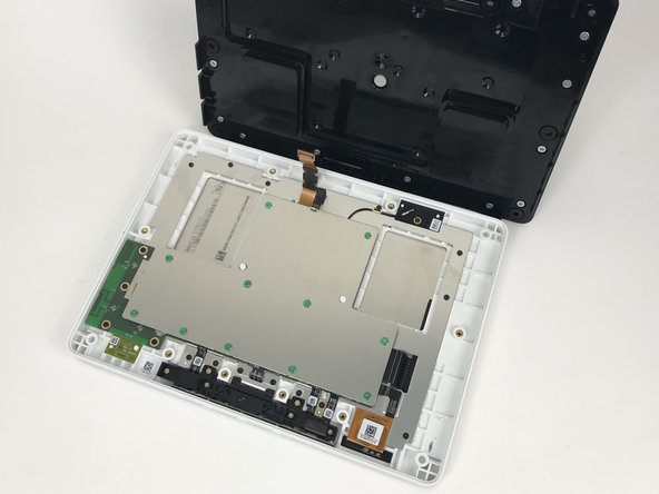

    1. Amazon Echo Show 2nd Gen Button Replacement, Button: crwdns2935265:03crwdnd2935265:01crwdnd2935265:02crwdne2935265:0 Amazon Echo Show 2nd Gen Button Replacement, Button: crwdns2935265:03crwdnd2935265:02crwdnd2935265:02crwdne2935265:0
      • Firmly grasp the white trim of the front piece with one hand while the other pulls back on the black back portion of the device.

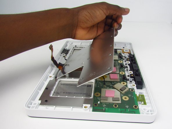

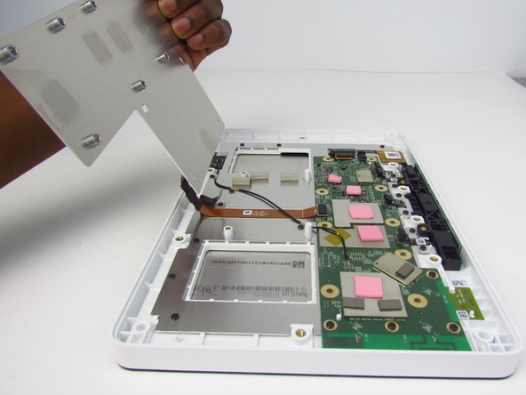

    2. Amazon Echo Show 2nd Gen Button Replacement: crwdns2935265:04crwdnd2935265:01crwdnd2935265:03crwdne2935265:0 Amazon Echo Show 2nd Gen Button Replacement: crwdns2935265:04crwdnd2935265:02crwdnd2935265:03crwdne2935265:0 Amazon Echo Show 2nd Gen Button Replacement: crwdns2935265:04crwdnd2935265:03crwdnd2935265:03crwdne2935265:0
      • Remove all of the red 2 mm screws using a T5 torx screwdriver.
      • Carefully lift away the metal plate.

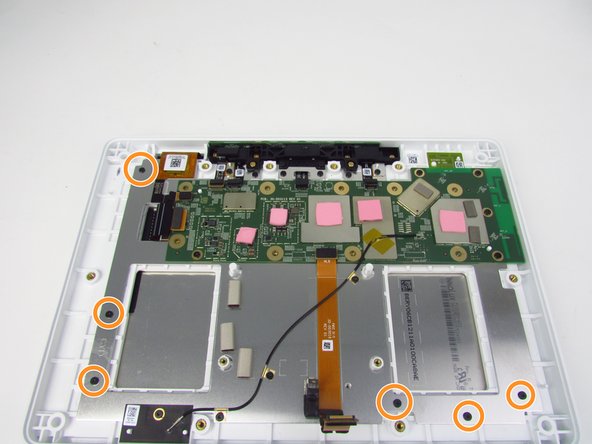

    3. Amazon Echo Show 2nd Gen Button Replacement: crwdns2935265:05crwdnd2935265:01crwdnd2935265:02crwdne2935265:0 Amazon Echo Show 2nd Gen Button Replacement: crwdns2935265:05crwdnd2935265:02crwdnd2935265:02crwdne2935265:0
      • Using a T5 torx screwdriver, remove all 2 mm screws from the motherboard.
      • Remove all orange marked screws from the second metal plate.

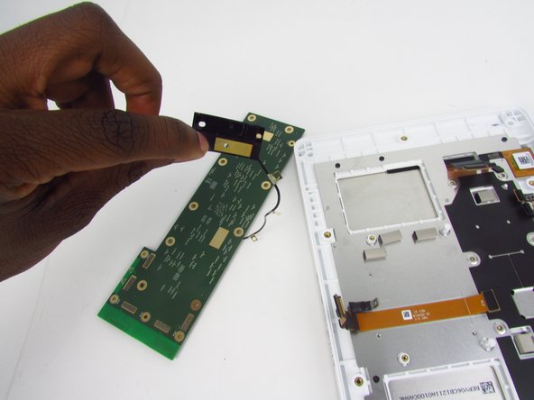

    4. Amazon Echo Show 2nd Gen Button Replacement: crwdns2935265:06crwdnd2935265:01crwdnd2935265:03crwdne2935265:0 Amazon Echo Show 2nd Gen Button Replacement: crwdns2935265:06crwdnd2935265:02crwdnd2935265:03crwdne2935265:0 Amazon Echo Show 2nd Gen Button Replacement: crwdns2935265:06crwdnd2935265:03crwdnd2935265:03crwdne2935265:0
      • Remove the motherboard from the device. Be sure to be careful when removing the black adhesive.

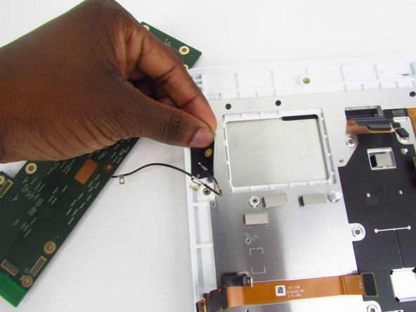

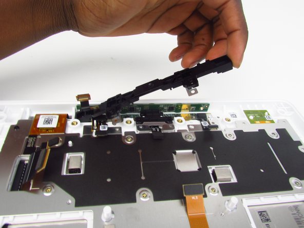

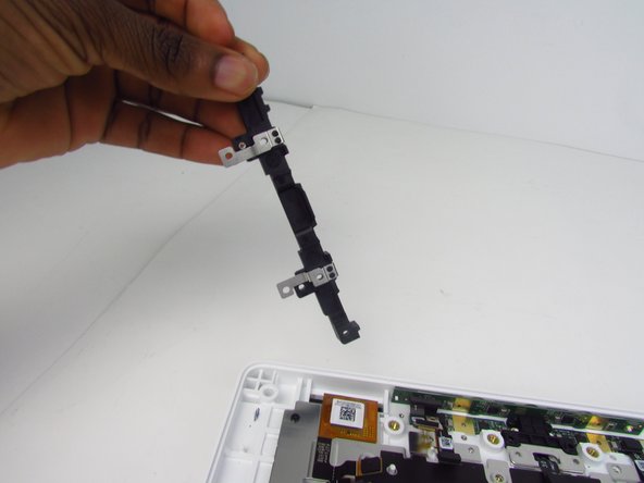

    5. Amazon Echo Show 2nd Gen Button Replacement: crwdns2935265:07crwdnd2935265:01crwdnd2935265:03crwdne2935265:0 Amazon Echo Show 2nd Gen Button Replacement: crwdns2935265:07crwdnd2935265:02crwdnd2935265:03crwdne2935265:0 Amazon Echo Show 2nd Gen Button Replacement: crwdns2935265:07crwdnd2935265:03crwdnd2935265:03crwdne2935265:0
      • Remove all 2 mm screws that are attached to the black plastic button casing.
      • Remove the case that holds the buttons. Buttons should now be free to remove.

These instructions are missing one important step, at least on my version of the Echo Show 10 2nd gen. There are 8 Tr8 screws holding the big black backside with the speakers + sound card in place 4 at the top, 2 on each side and 2 at the bottom.
These 8 screws need to be removed before separating the back from the front in Step 3 of this guide.
