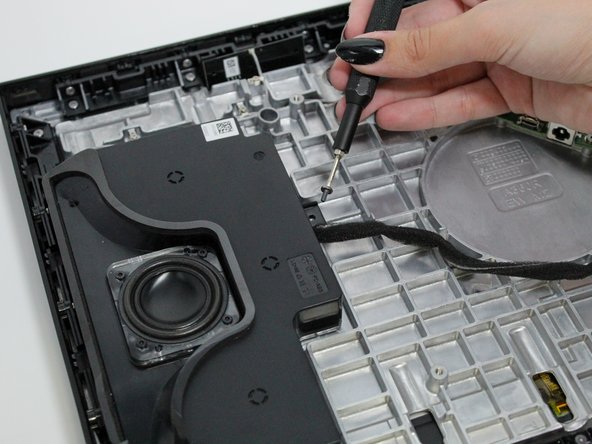

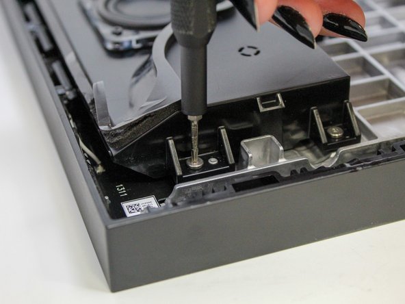

  3. Amazon Echo Show 15 Speaker Replacement, Speaker: crwdns2935265:03crwdnd2935265:01crwdnd2935265:03crwdne2935265:0 Amazon Echo Show 15 Speaker Replacement, Speaker: crwdns2935265:03crwdnd2935265:02crwdnd2935265:03crwdne2935265:0 Amazon Echo Show 15 Speaker Replacement, Speaker: crwdns2935265:03crwdnd2935265:03crwdnd2935265:03crwdne2935265:0
    • Remove the five 2 mm screws per speaker (ten total) with a Torx T5 screwdriver.

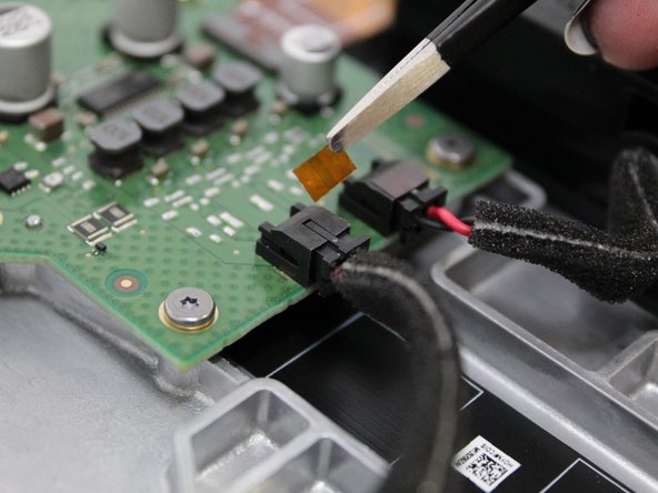

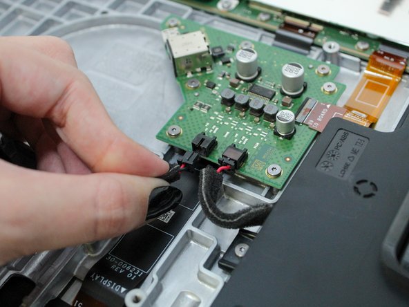

    • Locate the motherboard and the cables connected to the speakers.
    • Remove the orange sticker on top of the cord using a pair of tweezers.
    • Unplug the cable by pulling it towards you.

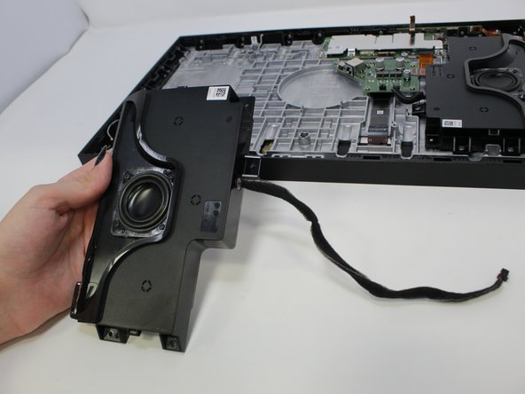

  5. Amazon Echo Show 15 Speaker Replacement: crwdns2935265:05crwdnd2935265:01crwdnd2935265:02crwdne2935265:0 Amazon Echo Show 15 Speaker Replacement: crwdns2935265:05crwdnd2935265:02crwdnd2935265:02crwdne2935265:0
    • Remove the speaker.
