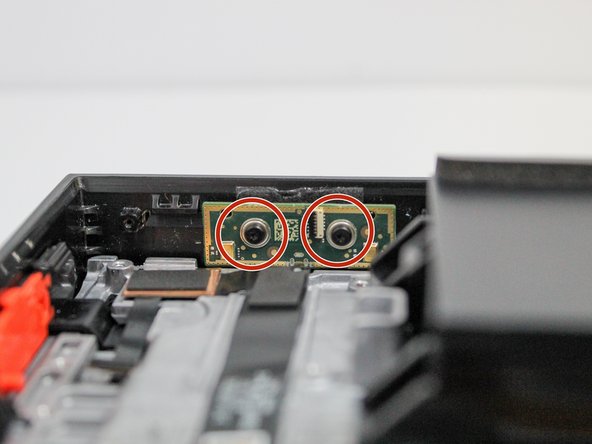

    1. Amazon Echo Show 15 Microphone Replacement, Microphone: crwdns2935265:04crwdnd2935265:01crwdnd2935265:02crwdne2935265:0 Amazon Echo Show 15 Microphone Replacement, Microphone: crwdns2935265:04crwdnd2935265:02crwdnd2935265:02crwdne2935265:0
      • Locate the microphone panel on the top right hand corner.
      • Remove the two 3 mm screws with a Torx T3 screwdriver.

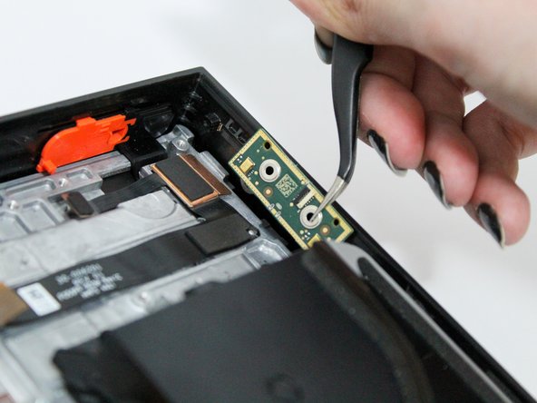

    2. Amazon Echo Show 15 Microphone Replacement: crwdns2935265:05crwdnd2935265:01crwdnd2935265:02crwdne2935265:0 Amazon Echo Show 15 Microphone Replacement: crwdns2935265:05crwdnd2935265:02crwdnd2935265:02crwdne2935265:0
      • Remove the microphone.
      • You may use tweezers for this step if necessary.
