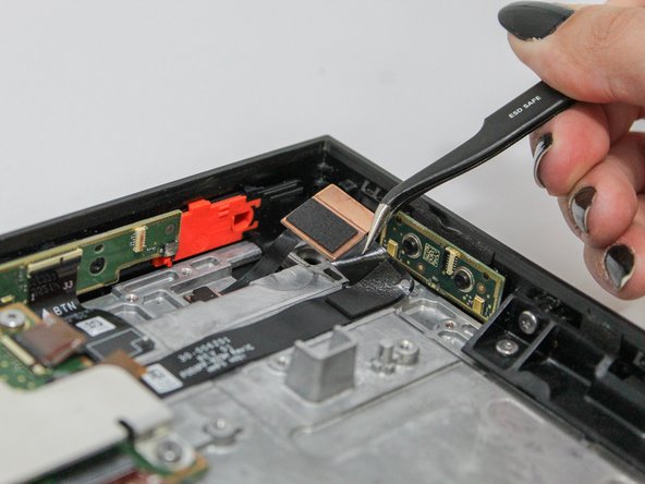

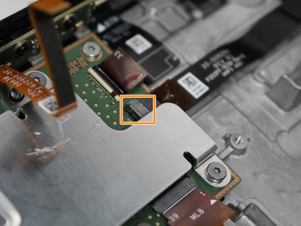

    1. Amazon Echo Show 15 Camera Replacement, Camera: crwdns2935265:04crwdnd2935265:01crwdnd2935265:03crwdne2935265:0 Amazon Echo Show 15 Camera Replacement, Camera: crwdns2935265:04crwdnd2935265:02crwdnd2935265:03crwdne2935265:0 Amazon Echo Show 15 Camera Replacement, Camera: crwdns2935265:04crwdnd2935265:03crwdnd2935265:03crwdne2935265:0
      • Remove the small connector from the main device.
      • Disconnect the camera cord from the motherboard.
      • Pull the camera out of the main device.
      • The camera is connected to the main device with adhesive. You will need to use a bit more force to get it out.
