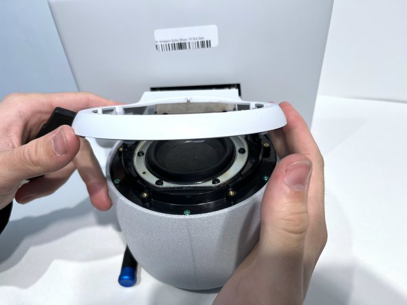

      • Release the adhesive seal connecting the bezel to the main base by inserting a Jimmy underneath the edge, and gently sliding from one side to another.
      • Lift up the outermost edge of the plastic bezel (furthest from the display) to remove it and set it aside.
      • After removing the screws in the previous step, the only thing holding this component in place is glue. You may need to apply a little force to break the seal created by any remaining glue to remove the bezel component. You could also apply a little heat with the iOpener to loosen the adhesive.

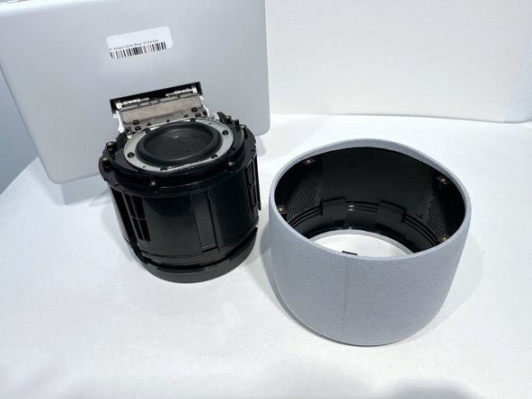

      • With one hand securely holding the neck of the display and the other holding the device base, gently lift the device out of the mesh shell.
      • Place the shell aside.

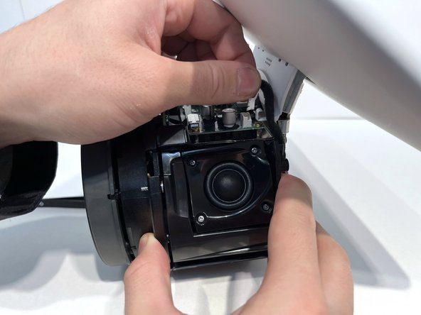

      • Rotate the device to lay on its side with the tweeter's exterior facing you.
      • Unhook the 3-pin connector attaching the tweeter to the base with your fingers. Hold it as close to the base of the cord as possible, and lift it directly up from the socket.
    7. Amazon Echo Show 10 3rd Gen Tweeter Replacement: crwdns2935265:07crwdnd2935265:01crwdnd2935265:01crwdne2935265:0
      • Use a Phillips screwdriver to remove the four 10 mm screws attaching the tweeter to the main speaker base.
    8. Amazon Echo Show 10 3rd Gen Tweeter Replacement: crwdns2935265:08crwdnd2935265:01crwdnd2935265:01crwdne2935265:0
      • Remove the tweeter.
      • Repeat the previous steps if you are removing the other tweeter.
