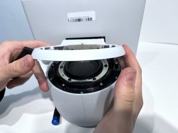

    • With the echo device standing upright, firmly grip the base and use the blue opening tool to gently pry the lid from the mesh speaker base.
    • Remove the lid and set it aside.
  2. Amazon Echo Show 10 3rd Gen Swivel Motor Replacement: crwdns2935265:02crwdnd2935265:01crwdnd2935265:01crwdne2935265:0
    • Use a TR8 Torx Security screwdriver to remove the six 9 mm screws from the perimeter of the plastic bezel on the top edge of the device.
  3. Amazon Echo Show 10 3rd Gen Swivel Motor Replacement: crwdns2935265:03crwdnd2935265:01crwdnd2935265:02crwdne2935265:0 Amazon Echo Show 10 3rd Gen Swivel Motor Replacement: crwdns2935265:03crwdnd2935265:02crwdnd2935265:02crwdne2935265:0
    • Release the adhesive seal connecting the bezel to the main base by inserting a Jimmy underneath the edge, and gently sliding from one side to another.
    • Lift up the outermost edge of the plastic bezel (furthest from the display) to remove it and set it aside.
    • After removing the screws in the previous step, the only thing holding this component in place is glue. You may need to apply a little force to break the seal created by any remaining glue to remove the bezel component. You could also apply a little heat with the iOpener to loosen the adhesive.

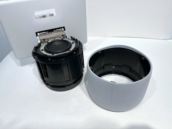

    • With one hand securely holding the neck of the display and the other holding the device base, gently lift the device out of the mesh shell.
    • Place the shell aside.

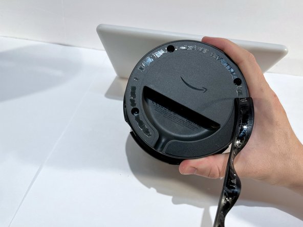

    • Turn the device on its side with the bottom facing upwards and out.
    • Use a blue opening tool along the edge of the base to pry off the adhesive strip.
    • Gently pull off the strip and place it aside.
    • A little force is necessary to separate the rubber strip from the feet of the device
  7. Amazon Echo Show 10 3rd Gen Swivel Motor Replacement: crwdns2935265:07crwdnd2935265:01crwdnd2935265:02crwdne2935265:0 Amazon Echo Show 10 3rd Gen Swivel Motor Replacement: crwdns2935265:07crwdnd2935265:02crwdnd2935265:02crwdne2935265:0

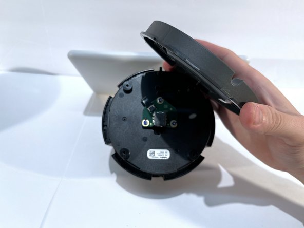

    • Use a T10 Torx screwdriver to remove the four 9 mm screws from the perimeter of the bottom surface of the device.
    • Remove the plastic base cover and set it aside.

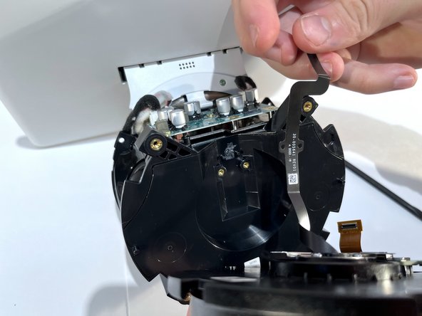

    • Tilt the device so the side of the base beneath the connection to the display is facing upwards and in clear view.

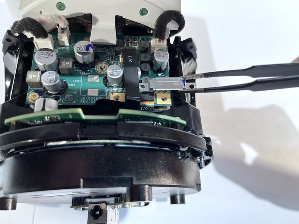

    • Use a T6 Torx screwdriver to remove the two 7 mm screws from the bracket covering the ribbon cable attached to the motor mount.
    • Use blunt nose tweezers to carefully remove the ribbon cable bracket and set it aside.
  10. Amazon Echo Show 10 3rd Gen Swivel Motor Replacement: crwdns2935265:010crwdnd2935265:01crwdnd2935265:01crwdne2935265:0
    • Place the tip of your opening tool under the edge of the press connector, and pry the connector straight up from its socket.
    • Be very careful to pry only under the edge of the connector, and not under the socket itself. If you pry under the socket, you will separate it from the circuit board, which requires specialized microsoldering skills and equipment to repair.
    • To reconnect, align the connector carefully over its socket and press down with your fingertip—first at one side, then the other—until it clicks into place.
  11. Amazon Echo Show 10 3rd Gen Swivel Motor Replacement: crwdns2935265:011crwdnd2935265:01crwdnd2935265:03crwdne2935265:0 Amazon Echo Show 10 3rd Gen Swivel Motor Replacement: crwdns2935265:011crwdnd2935265:02crwdnd2935265:03crwdne2935265:0 Amazon Echo Show 10 3rd Gen Swivel Motor Replacement: crwdns2935265:011crwdnd2935265:03crwdnd2935265:03crwdne2935265:0

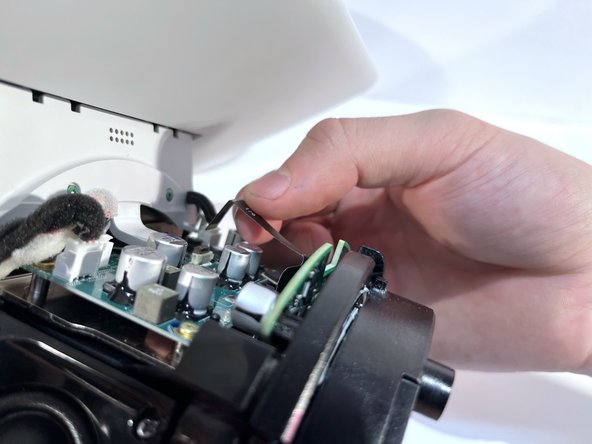

    • Use blunt nose tweezers to lift up the back of the connector to disconnect the ribbon from the socket.
    • Use tweezers or your fingers to gently grip the ribbon cable and pull away from the board.
    • Make sure the cable is only being held in place by its connection to the motor and the silver bracket on the underside of the base.
  12. Amazon Echo Show 10 3rd Gen Swivel Motor Replacement: crwdns2935265:012crwdnd2935265:01crwdnd2935265:03crwdne2935265:0 Amazon Echo Show 10 3rd Gen Swivel Motor Replacement: crwdns2935265:012crwdnd2935265:02crwdnd2935265:03crwdne2935265:0 Amazon Echo Show 10 3rd Gen Swivel Motor Replacement: crwdns2935265:012crwdnd2935265:03crwdnd2935265:03crwdne2935265:0

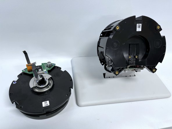

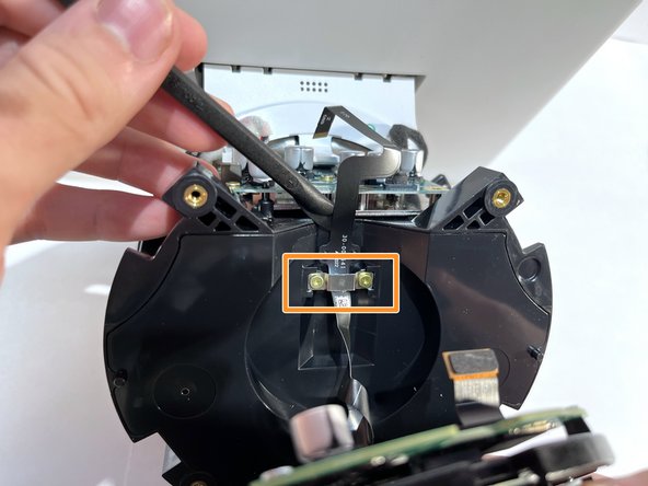

    • Use a T6 Torx screwdriver to remove the two 7 mm screws from the silver cable bracket on the motor mount.
    • Remove the bracket, pull away the ribbon cable, and remove the motor.
    • The ribbon cable is held in place by a small spot of adhesive above the bracket. Gently pull away the ribbon cable to break the seal, or a nylon spudger to work through it.
