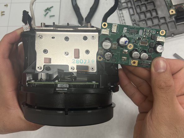

  9. Amazon Echo Show 10 3rd Gen Speaker PCB Replacement, Speaker PCB: crwdns2935265:09crwdnd2935265:01crwdnd2935265:01crwdne2935265:0
    • Remove the six 6.8 mm T6 Torx screws.
  10. Amazon Echo Show 10 3rd Gen Speaker PCB Replacement: crwdns2935265:010crwdnd2935265:01crwdnd2935265:02crwdne2935265:0 Amazon Echo Show 10 3rd Gen Speaker PCB Replacement: crwdns2935265:010crwdnd2935265:02crwdnd2935265:02crwdne2935265:0
    • Gently lift up the press connector to disconnect it.
    • Remove the PCB.

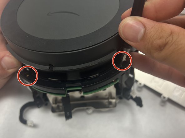

    • Remove the four 10.7 mm T8 Torx screws.

    • Remove the two 6.8 mm T6 Torx screws that secure the bracket.

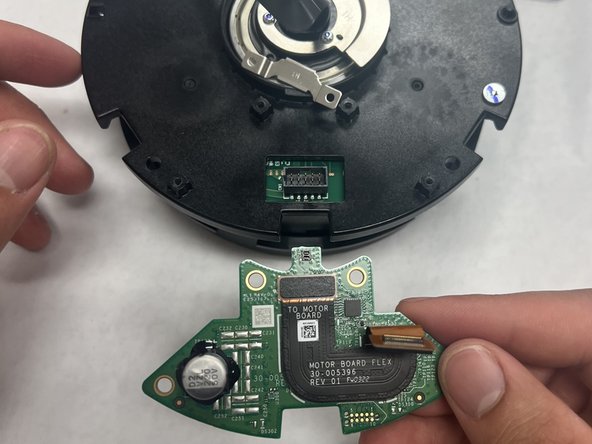

  13. Amazon Echo Show 10 3rd Gen Speaker PCB Replacement: crwdns2935265:013crwdnd2935265:01crwdnd2935265:02crwdne2935265:0 Amazon Echo Show 10 3rd Gen Speaker PCB Replacement: crwdns2935265:013crwdnd2935265:02crwdnd2935265:02crwdne2935265:0
    • Remove the two 9.3 mm T6 Torx screws that secure the speaker PCB.
    • Remove the speaker PCB.
