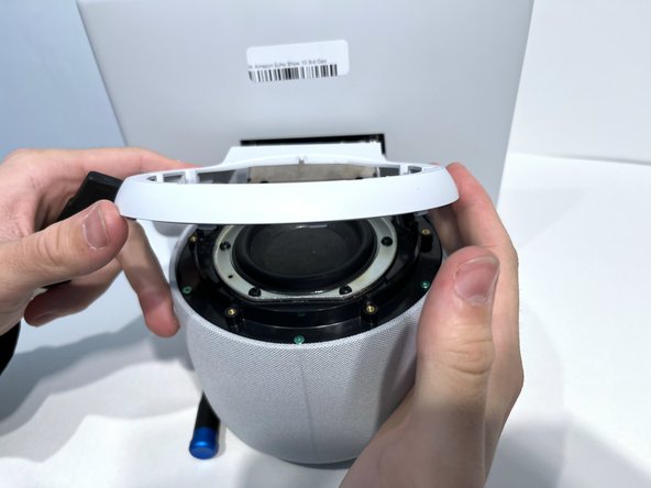

  3. Amazon Echo Show 10 3rd Gen Power Jack Replacement: crwdns2935265:03crwdnd2935265:01crwdnd2935265:02crwdne2935265:0 Amazon Echo Show 10 3rd Gen Power Jack Replacement: crwdns2935265:03crwdnd2935265:02crwdnd2935265:02crwdne2935265:0
    • Release the adhesive seal connecting the bezel to the main base by inserting a Jimmy underneath the edge, and gently sliding from one side to another.
    • Lift up the outermost edge of the plastic bezel (furthest from the display) to remove it and set it aside.
    • After removing the screws in the previous step, the only thing holding this component in place is glue. You may need to apply a little force to break the seal created by any remaining glue to remove the bezel component. You could also apply a little heat with the iOpener to loosen the adhesive.

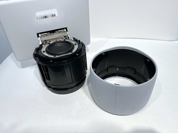

  5. Amazon Echo Show 10 3rd Gen Power Jack Replacement: crwdns2935265:05crwdnd2935265:01crwdnd2935265:02crwdne2935265:0 Amazon Echo Show 10 3rd Gen Power Jack Replacement: crwdns2935265:05crwdnd2935265:02crwdnd2935265:02crwdne2935265:0
    • With one hand securely holding the neck of the display and the other holding the device base, gently lift the device out of the mesh shell.
    • Place the shell aside.

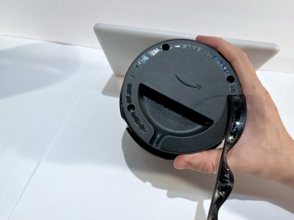

  6. Amazon Echo Show 10 3rd Gen Power Jack Replacement: crwdns2935265:06crwdnd2935265:01crwdnd2935265:02crwdne2935265:0 Amazon Echo Show 10 3rd Gen Power Jack Replacement: crwdns2935265:06crwdnd2935265:02crwdnd2935265:02crwdne2935265:0
    • Turn the device on its side with the bottom facing upwards and out.
    • Use a blue opening tool along the edge of the base to pry off the adhesive strip.
    • Gently pull off the strip and place it aside.
    • A little force is necessary to separate the rubber strip from the feet of the device.

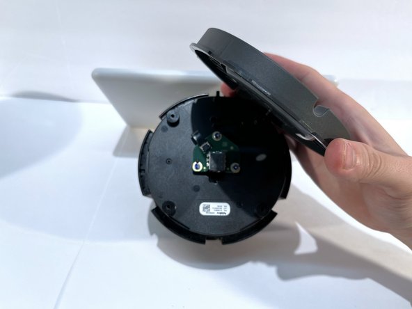

  7. Amazon Echo Show 10 3rd Gen Power Jack Replacement: crwdns2935265:07crwdnd2935265:01crwdnd2935265:02crwdne2935265:0 Amazon Echo Show 10 3rd Gen Power Jack Replacement: crwdns2935265:07crwdnd2935265:02crwdnd2935265:02crwdne2935265:0
    • Use a Torx T10 screwdriver to remove the four 9 mm screws from the perimeter of the bottom surface of the device.
    • Remove the plastic base cover and set it aside.

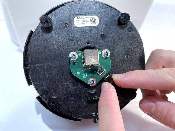

  8. Amazon Echo Show 10 3rd Gen Power Jack Replacement: crwdns2935265:08crwdnd2935265:01crwdnd2935265:02crwdne2935265:0 Amazon Echo Show 10 3rd Gen Power Jack Replacement: crwdns2935265:08crwdnd2935265:02crwdnd2935265:02crwdne2935265:0
    • Use a nylon spudger to flip up the small locking flap on the ribbon cable connector and gently pull the cable out.
  9. Amazon Echo Show 10 3rd Gen Power Jack Replacement: crwdns2935265:09crwdnd2935265:01crwdnd2935265:01crwdne2935265:0
    • Use a Torx T6 screwdriver to remove the three 9 mm screws from the power board.
  10. Amazon Echo Show 10 3rd Gen Power Jack Replacement: crwdns2935265:010crwdnd2935265:01crwdnd2935265:01crwdne2935265:0
    • Lift the power board from the base.
