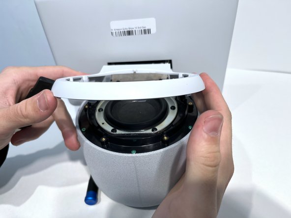

    • Use a TR8 Torx Security screwdriver to remove the six 9 mm screws from the perimeter of the plastic bezel on the top edge of the device.
  3. Amazon Echo Show 10 3rd Gen Microphone Replacement: crwdns2935265:03crwdnd2935265:01crwdnd2935265:02crwdne2935265:0 Amazon Echo Show 10 3rd Gen Microphone Replacement: crwdns2935265:03crwdnd2935265:02crwdnd2935265:02crwdne2935265:0
    • Release the adhesive seal connecting the bezel to the main base by inserting a Jimmy underneath the edge, and gently sliding from one side to another.
    • Lift up the outermost edge of the plastic bezel (furthest from the display) to remove it and set it aside.
    • After removing the screws in the previous step, the only thing holding this component in place is glue. You may need to apply a little force to break the seal created by any remaining glue to remove the bezel component. You could also apply a little heat with the iOpener to loosen the adhesive.

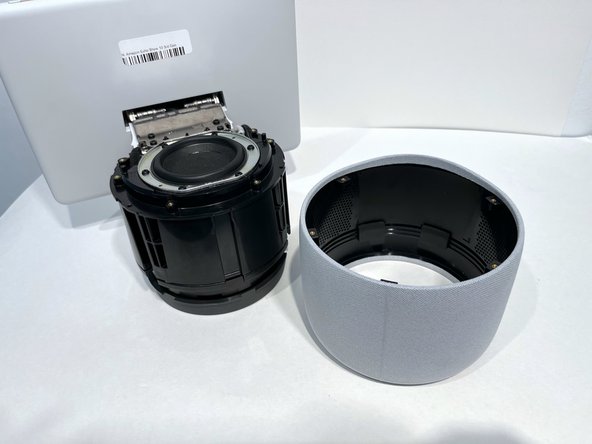

    • Use a Torx T6 screwdriver to remove the five 10 mm screws from the perimeter of the top surface of the base.
  5. Amazon Echo Show 10 3rd Gen Microphone Replacement: crwdns2935265:05crwdnd2935265:01crwdnd2935265:02crwdne2935265:0 Amazon Echo Show 10 3rd Gen Microphone Replacement: crwdns2935265:05crwdnd2935265:02crwdnd2935265:02crwdne2935265:0
    • With one hand securely holding the neck of the display and the other holding the device base, gently lift the device out of the mesh shell.
    • Place the shell aside.

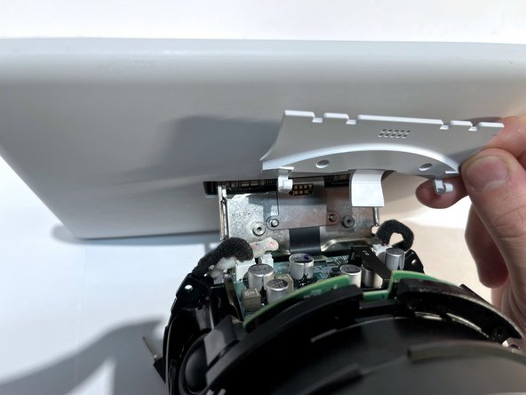

    • Use a T6 Torx screwdriver to remove the two 5mm screws from the underside of the display neck.
  7. Amazon Echo Show 10 3rd Gen Microphone Replacement: crwdns2935265:07crwdnd2935265:01crwdnd2935265:02crwdne2935265:0 Amazon Echo Show 10 3rd Gen Microphone Replacement: crwdns2935265:07crwdnd2935265:02crwdnd2935265:02crwdne2935265:0
    • Lift the plate up to remove it from the neck of the device.
    • Set it aside for reassembly.

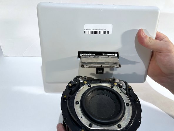

  9. Amazon Echo Show 10 3rd Gen Microphone Replacement: crwdns2935265:09crwdnd2935265:01crwdnd2935265:01crwdne2935265:0
    • Tilt the device so it is in the upright position.
    • Use a TR10 Torx Security screwdriver to remove the four 11 mm screws from the top of the display neck.
  10. Amazon Echo Show 10 3rd Gen Microphone Replacement: crwdns2935265:010crwdnd2935265:01crwdnd2935265:02crwdne2935265:0 Amazon Echo Show 10 3rd Gen Microphone Replacement: crwdns2935265:010crwdnd2935265:02crwdnd2935265:02crwdne2935265:0
    • Gently lift the display and its connecting neck off of the base.

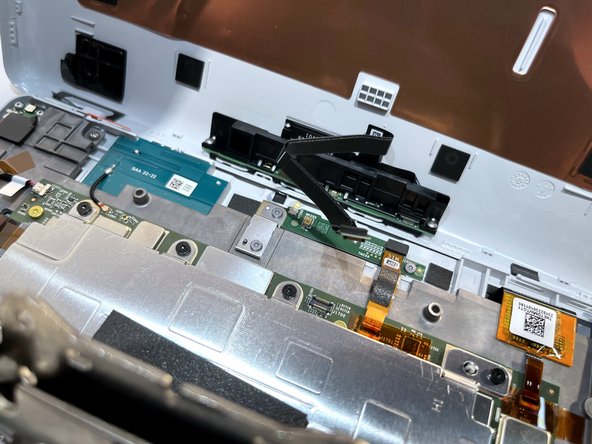

  11. Amazon Echo Show 10 3rd Gen Microphone Replacement, Microphone: crwdns2935265:011crwdnd2935265:01crwdnd2935265:01crwdne2935265:0
    • Insert a Jimmy along the seam of the screen and the shell and slide it along the length to separate the two sides.
    • For this particular step, a careful amount of force may be needed to separate the two parts. The connection is especially tight at the four corners. Use the iOpener to loosen the small amount of adhesive.

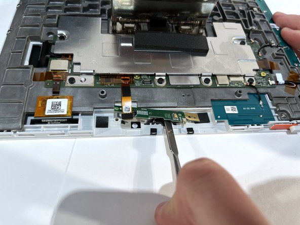

  15. Amazon Echo Show 10 3rd Gen Microphone Replacement: crwdns2935265:015crwdnd2935265:01crwdnd2935265:01crwdne2935265:0

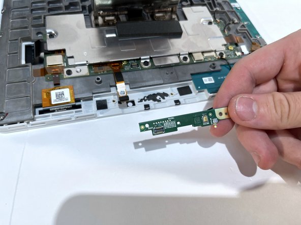

    • Use the T5 Torx screwdriver to remove the two 4 mm screws from the bracket covering the microphone board and the one 4 mm screw holding down the board itself.
  16. Amazon Echo Show 10 3rd Gen Microphone Replacement: crwdns2935265:016crwdnd2935265:01crwdnd2935265:03crwdne2935265:0 Amazon Echo Show 10 3rd Gen Microphone Replacement: crwdns2935265:016crwdnd2935265:02crwdnd2935265:03crwdne2935265:0 Amazon Echo Show 10 3rd Gen Microphone Replacement: crwdns2935265:016crwdnd2935265:03crwdnd2935265:03crwdne2935265:0
    • Use a spudger to pry under the microphone board. and gently wear away at the connecting glue.
    • The board is glued on so use the spudger to release the glue. It may take some time but be patient to avoid damaging the device.
    • The microphone component is delicate and relatively flimsy, so a gentle approach to breaking the adhesive is recommended.
    • After the adhesive seal has been broken, gently lift and remove the microphone board.
