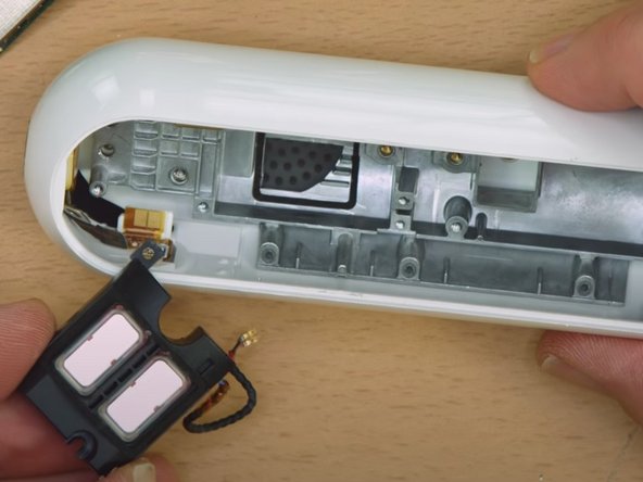

  10. Amazon Echo Look Speaker Replacement, Speaker: crwdns2935265:010crwdnd2935265:01crwdnd2935265:01crwdne2935265:0
    • Remove screws with a T4 Torx screwdriver.
    • Using pliers, remove the copper-plated sections.
  11. Amazon Echo Look Speaker Replacement: crwdns2935265:011crwdnd2935265:01crwdnd2935265:02crwdne2935265:0 Amazon Echo Look Speaker Replacement: crwdns2935265:011crwdnd2935265:02crwdnd2935265:02crwdne2935265:0
    • Remove the speaker with pliers.
