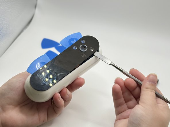

    • Lever the Jimmy between the screen and the device until an opening is formed.
    • Insert opening picks to hold the opening as needed.
    • Use a spudger to circle the border of the front panel and disconnect any lingering glue.
    • Step 3 may need to be repeated as Step 4 is time-sensitive.

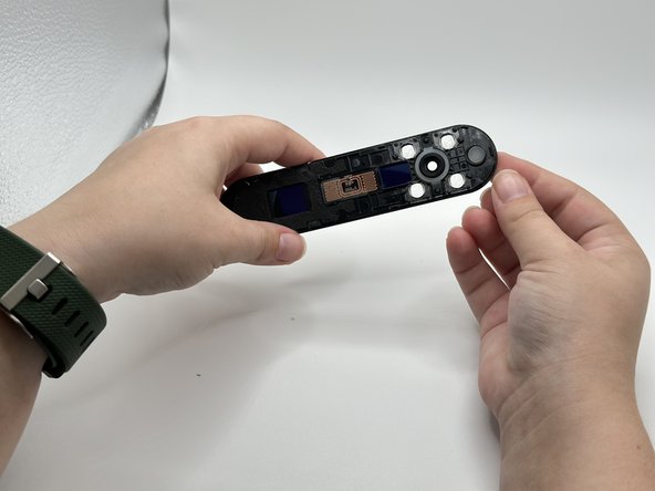

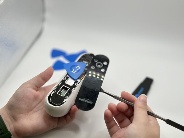

  5. Amazon Echo Look Midframe Replacement: crwdns2935265:05crwdnd2935265:01crwdnd2935265:02crwdne2935265:0 Amazon Echo Look Midframe Replacement: crwdns2935265:05crwdnd2935265:02crwdnd2935265:02crwdne2935265:0
    • Remove the front panel by levering the spudger at the top of the device.

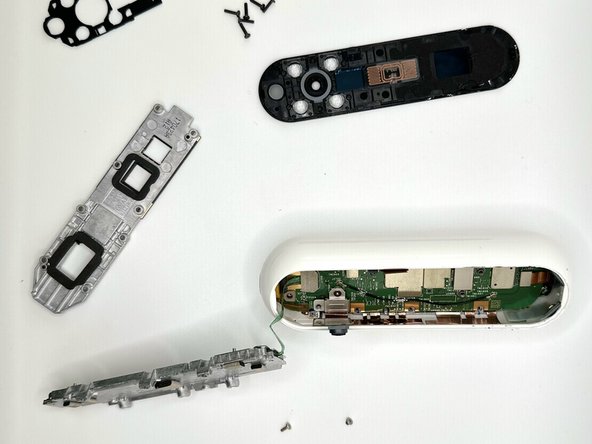

  6. Amazon Echo Look Midframe Replacement, Midframe: crwdns2935265:06crwdnd2935265:01crwdnd2935265:02crwdne2935265:0 Amazon Echo Look Midframe Replacement, Midframe: crwdns2935265:06crwdnd2935265:02crwdnd2935265:02crwdne2935265:0
    • Remove the screws from the midframe with a Torx T5 screwdriver.
    • Lift up the midframe
    • Remove the eight screws attached to the gray metal piece using a Torx T5 screwdriver.
  7. Amazon Echo Look Midframe Replacement: crwdns2935265:07crwdnd2935265:01crwdnd2935265:02crwdne2935265:0 Amazon Echo Look Midframe Replacement: crwdns2935265:07crwdnd2935265:02crwdnd2935265:02crwdne2935265:0
    • Use a spudger to gently lift up the ribbon until it detaches.
