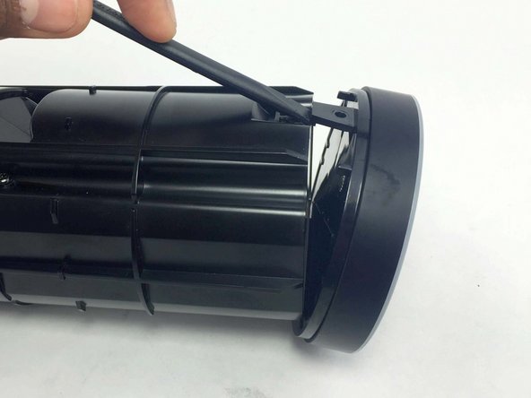

      • Using the spudger, pull back the two plastic clips on the plate.
      • Lift the board up and pull it away from the plate.

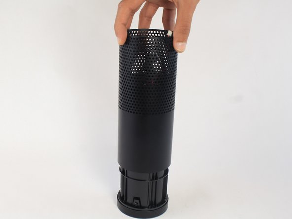

      • Remove the plastic plate from the bottom of the device. Then remove the plastic shrouding.
    2. Amazon Echo LED/Microphone Board Replacement: crwdns2935265:08crwdnd2935265:01crwdnd2935265:01crwdne2935265:0
      • Peel off the black fabric wrapped around the device.
      • Be careful not to rip the fabric. Use a spudger to help remove the adhesive if you have any trouble.

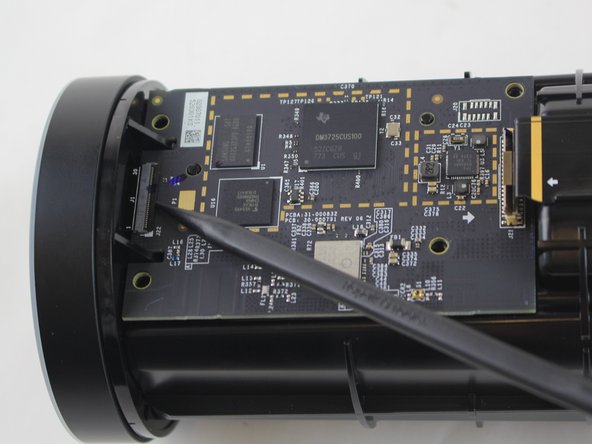

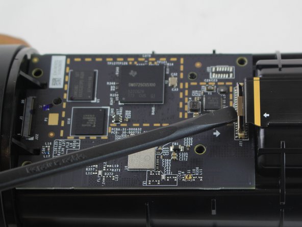

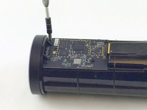

      • Lift the brown and black plastic latches securing the ZIF connectors at each end of the motherboard.
      • Pull the two ribbon cables from their connectors on the motherboard.
    5. Amazon Echo LED/Microphone Board Replacement: crwdns2935265:011crwdnd2935265:01crwdnd2935265:01crwdne2935265:0
      • Lift the motherboard up from the Echo.

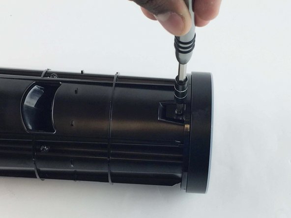

    1. Amazon Echo LED/Microphone Board Replacement, LED/Microphone Board: crwdns2935265:012crwdnd2935265:01crwdnd2935265:02crwdne2935265:0 Amazon Echo LED/Microphone Board Replacement, LED/Microphone Board: crwdns2935265:012crwdnd2935265:02crwdnd2935265:02crwdne2935265:0
      • Remove the 9.7 mm T10 Torx screw from the opposite side of the Echo.

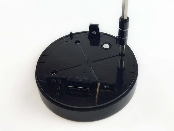

      • Unscrew the four 9.7 mm T9 torx screws from the bottom of the volume ring assembly.

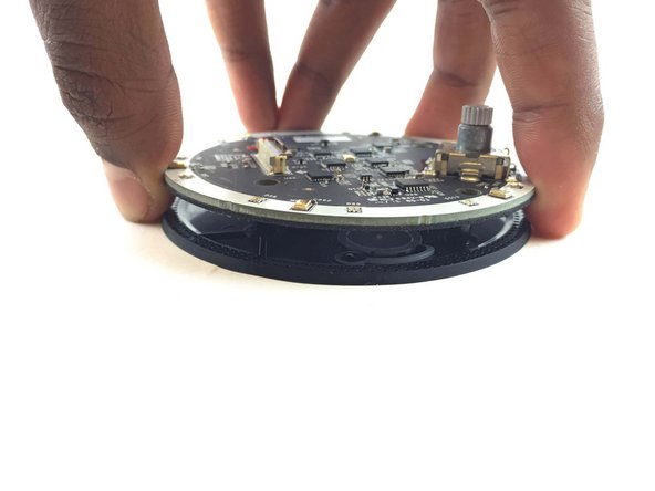

    4. Amazon Echo LED/Microphone Board Replacement: crwdns2935265:015crwdnd2935265:01crwdnd2935265:01crwdne2935265:0
      • Turn the assembly over and lift up the plate with the buttons.

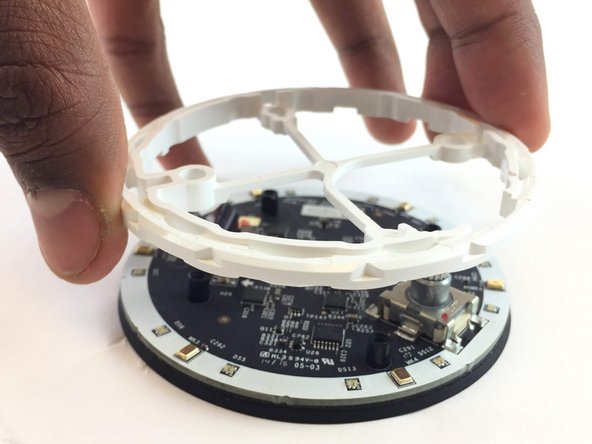

      • Turn the plate over, then lift and remove black gear and the white plastic ring.
