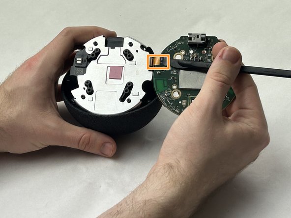

  3. Amazon Echo Dot 5th Generation Switch PCB Replacement Replacement: crwdns2935265:03crwdnd2935265:01crwdnd2935265:03crwdne2935265:0 Amazon Echo Dot 5th Generation Switch PCB Replacement Replacement: crwdns2935265:03crwdnd2935265:02crwdnd2935265:03crwdne2935265:0 Amazon Echo Dot 5th Generation Switch PCB Replacement Replacement: crwdns2935265:03crwdnd2935265:03crwdnd2935265:03crwdne2935265:0
    • Remove the CPU PCB by removing the 4 T6 0.75cm Torx screws.
    • Once removed, unclip the plastic retainer on the CPU PCB and slide the ribbon cable out. This will reveal the speaker’s metal housing.

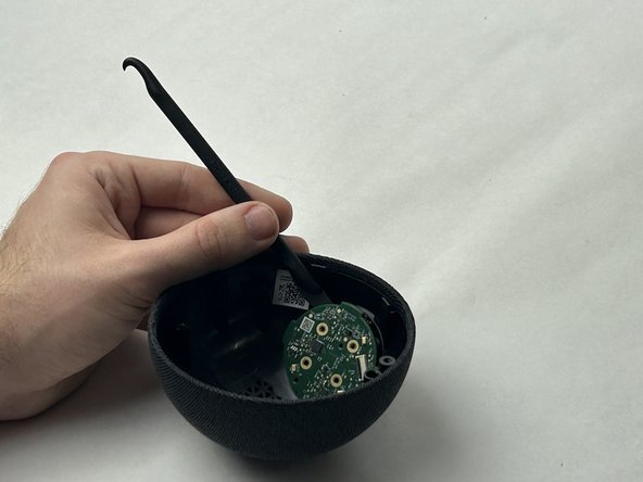

  5. Amazon Echo Dot 5th Generation Switch PCB Replacement Replacement: crwdns2935265:05crwdnd2935265:01crwdnd2935265:01crwdne2935265:0
    • Using the Torx T8 bit, remove the four 1.25 cm screws around the edges of the speaker housing, and lift the housing off of the top case, revealing the switch PCB.

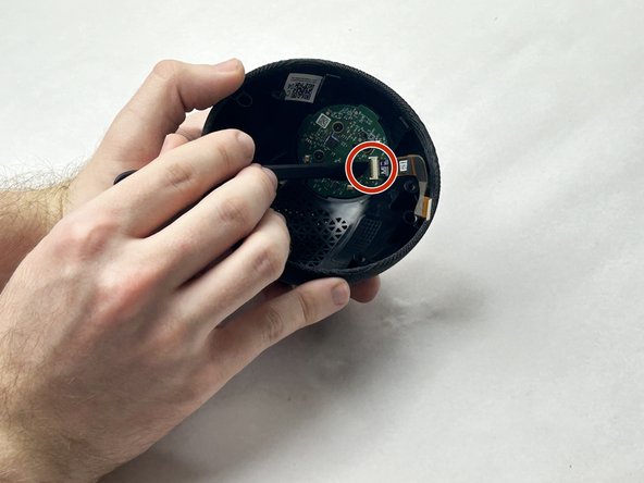

  6. Amazon Echo Dot 5th Generation Switch PCB Replacement Replacement: crwdns2935265:06crwdnd2935265:01crwdnd2935265:03crwdne2935265:0 Amazon Echo Dot 5th Generation Switch PCB Replacement Replacement: crwdns2935265:06crwdnd2935265:02crwdnd2935265:03crwdne2935265:0 Amazon Echo Dot 5th Generation Switch PCB Replacement Replacement: crwdns2935265:06crwdnd2935265:03crwdnd2935265:03crwdne2935265:0
    • Use a plastic spudger to undo the adhesive attaching the ribbon cable to the top case. Then, flip the tab on the switch PCB, and slide out the ribbon cable.

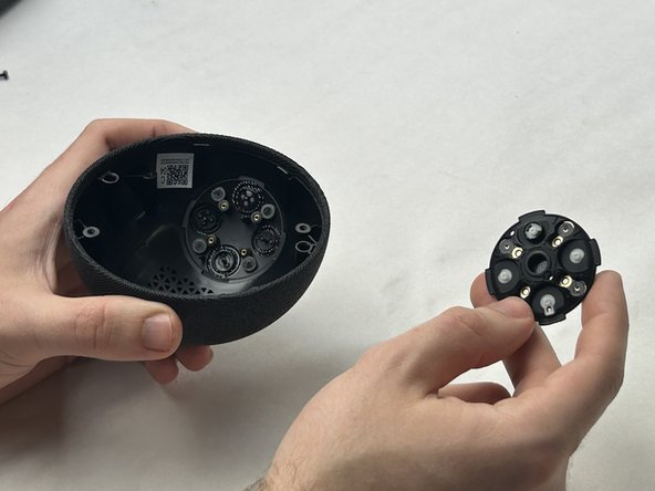

  7. Amazon Echo Dot 5th Generation Switch PCB Replacement Replacement, Switch PCB: crwdns2935265:07crwdnd2935265:01crwdnd2935265:03crwdne2935265:0 Amazon Echo Dot 5th Generation Switch PCB Replacement Replacement, Switch PCB: crwdns2935265:07crwdnd2935265:02crwdnd2935265:03crwdne2935265:0 Amazon Echo Dot 5th Generation Switch PCB Replacement Replacement, Switch PCB: crwdns2935265:07crwdnd2935265:03crwdnd2935265:03crwdne2935265:0
    • Remove the upper switch PCB using the T4 Torx bit to unscrew the four 5 mm screws.
    • The PCB is glued down in between the 4 buttons.
    • Push down on the buttons through the top of the case and pry lightly with plastic tools until loose, then remove.
