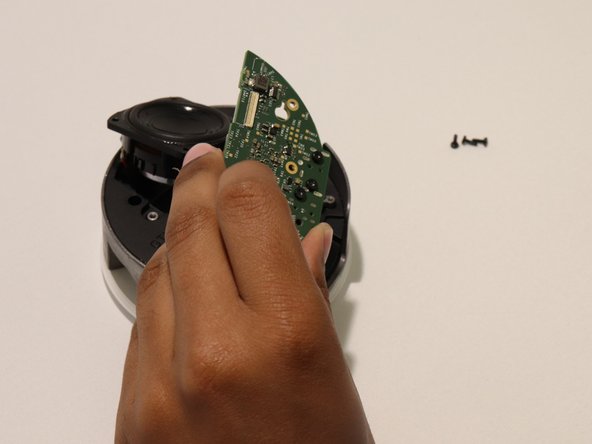

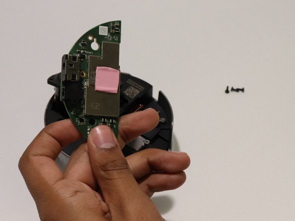

  5. Amazon Echo Dot 3rd Generation Motherboard Replacement, Motherboard: crwdns2935265:05crwdnd2935265:01crwdnd2935265:03crwdne2935265:0 Amazon Echo Dot 3rd Generation Motherboard Replacement, Motherboard: crwdns2935265:05crwdnd2935265:02crwdnd2935265:03crwdne2935265:0 Amazon Echo Dot 3rd Generation Motherboard Replacement, Motherboard: crwdns2935265:05crwdnd2935265:03crwdnd2935265:03crwdne2935265:0
    • Remove the four 6.2 mm screws from the motherboard using a T6 Torx screwdriver.
    • Remove the three 9.4 mm screws from the motherboard using a T6 Torx screwdriver.
  6. Amazon Echo Dot 3rd Generation Motherboard Replacement: crwdns2935265:06crwdnd2935265:01crwdnd2935265:03crwdne2935265:0 Amazon Echo Dot 3rd Generation Motherboard Replacement: crwdns2935265:06crwdnd2935265:02crwdnd2935265:03crwdne2935265:0 Amazon Echo Dot 3rd Generation Motherboard Replacement: crwdns2935265:06crwdnd2935265:03crwdnd2935265:03crwdne2935265:0
    • Remove the connecting head linking the motherboard to the device using a pair of tweezers.
    • Remove the old motherboard and replace it with the new one.
