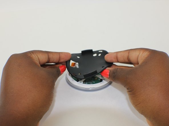

    • Power off and unplug the echo
    • Using the plastic opening tool, peel off the rubber layer on the bottom of the echo
  2. Amazon Echo Dot 2nd Generation Ribbon Cable Replacement: crwdns2935265:02crwdnd2935265:01crwdnd2935265:03crwdne2935265:0 Amazon Echo Dot 2nd Generation Ribbon Cable Replacement: crwdns2935265:02crwdnd2935265:02crwdnd2935265:03crwdne2935265:0 Amazon Echo Dot 2nd Generation Ribbon Cable Replacement: crwdns2935265:02crwdnd2935265:03crwdnd2935265:03crwdne2935265:0
    • Use a T8 screwdriver bit to unscrew the 1.6mm four screws.
    • Remove the black cylindrical base

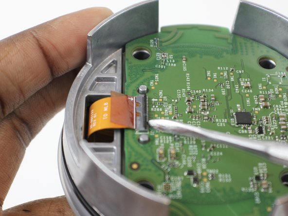

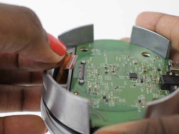

    • Use the metal spudger to lift the ZIF connector
    • Remove the ribbon cable from the slot

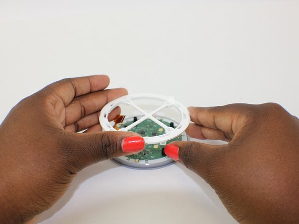

    • Remove the silver divider
    • Remove the black rubber divider
    • Remove the plastic white frame

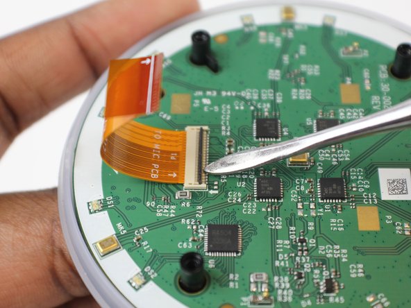

    • Remove the ribbon cable from the slot on the LED/speaker board
