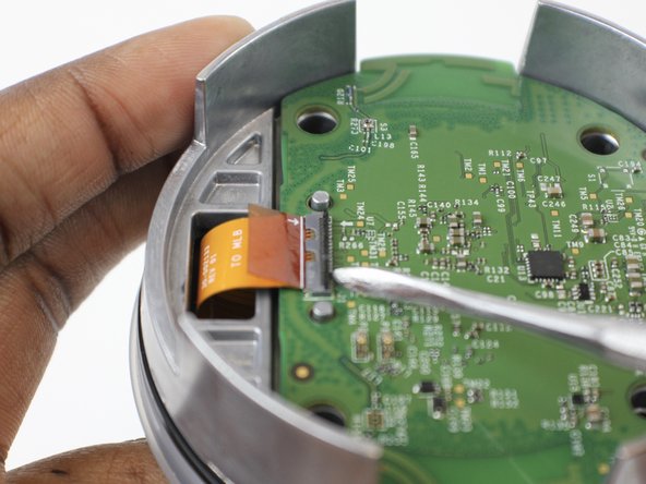

  3. Amazon Echo Dot 2nd Generation LED/Speaker Board and Microphone Replacement: crwdns2935265:03crwdnd2935265:01crwdnd2935265:03crwdne2935265:0 Amazon Echo Dot 2nd Generation LED/Speaker Board and Microphone Replacement: crwdns2935265:03crwdnd2935265:02crwdnd2935265:03crwdne2935265:0 Amazon Echo Dot 2nd Generation LED/Speaker Board and Microphone Replacement: crwdns2935265:03crwdnd2935265:03crwdnd2935265:03crwdne2935265:0
    • Use the metal spudger to lift the ZIF connector
    • Remove the ribbon cable from the slot

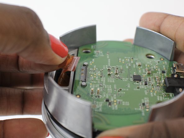

  4. Amazon Echo Dot 2nd Generation LED/Speaker Board and Microphone Replacement: crwdns2935265:04crwdnd2935265:01crwdnd2935265:01crwdne2935265:0
    • Remove the motherboard

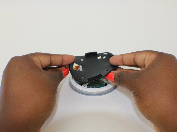

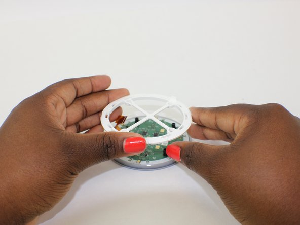

    • Remove the silver divider
    • Remove black rubber divider
    • Remove the plastic white frame

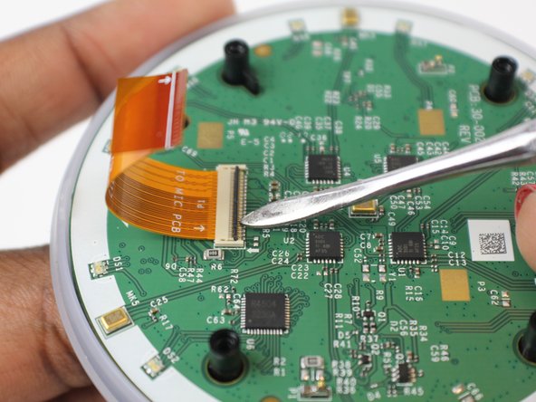

  6. Amazon Echo Dot 2nd Generation LED/Speaker Board and Microphone Replacement: crwdns2935265:06crwdnd2935265:01crwdnd2935265:03crwdne2935265:0 Amazon Echo Dot 2nd Generation LED/Speaker Board and Microphone Replacement: crwdns2935265:06crwdnd2935265:02crwdnd2935265:03crwdne2935265:0 Amazon Echo Dot 2nd Generation LED/Speaker Board and Microphone Replacement: crwdns2935265:06crwdnd2935265:03crwdnd2935265:03crwdne2935265:0
    • Remove the ribbon cable from the slot on the LED/speaker board
