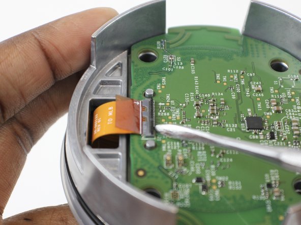

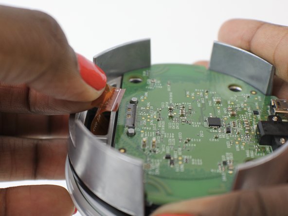

    • Use the metal spudger to lift the ZIF connector
    • Remove the ribbon cable from the slot

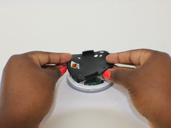

    • Remove the motherboard

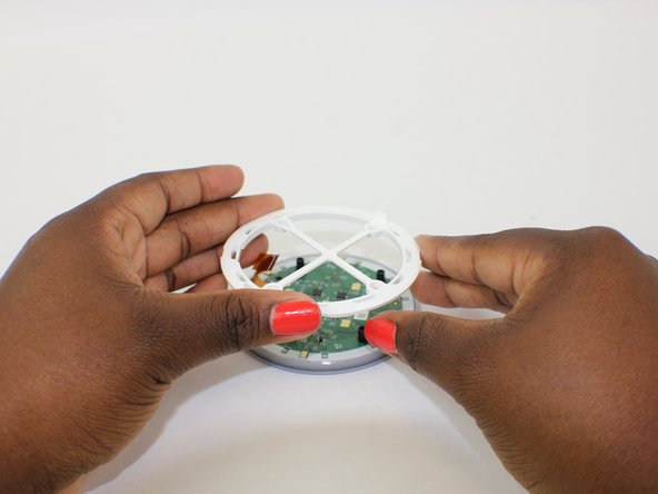

    • Remove the silver divider
    • Remove the black rubber divider
    • Remove the plastic white frame

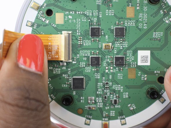

    • Remove the ribbon cable from the slot on the speaker board
  7. Amazon Echo Dot 2nd Generation Analog to Digital Convertor Replacement: crwdns2935265:07crwdnd2935265:01crwdnd2935265:01crwdne2935265:0
    • Remove the speaker board which contains the analog to digital converter
