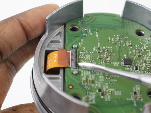

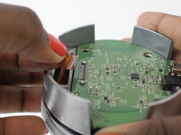

  3. Amazon Echo Dot 2nd Generation 4-in-1 WiFi/Bluetooth/FM/GPS Replacement: crwdns2935265:03crwdnd2935265:01crwdnd2935265:03crwdne2935265:0 Amazon Echo Dot 2nd Generation 4-in-1 WiFi/Bluetooth/FM/GPS Replacement: crwdns2935265:03crwdnd2935265:02crwdnd2935265:03crwdne2935265:0 Amazon Echo Dot 2nd Generation 4-in-1 WiFi/Bluetooth/FM/GPS Replacement: crwdns2935265:03crwdnd2935265:03crwdnd2935265:03crwdne2935265:0
    • Use the metal spudger to lift the ZIF connector
    • Remove the ribbon cable from the slot
  4. Amazon Echo Dot 2nd Generation 4-in-1 WiFi/Bluetooth/FM/GPS Replacement: crwdns2935265:04crwdnd2935265:01crwdnd2935265:01crwdne2935265:0
    • Remove the motherboard
