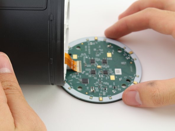

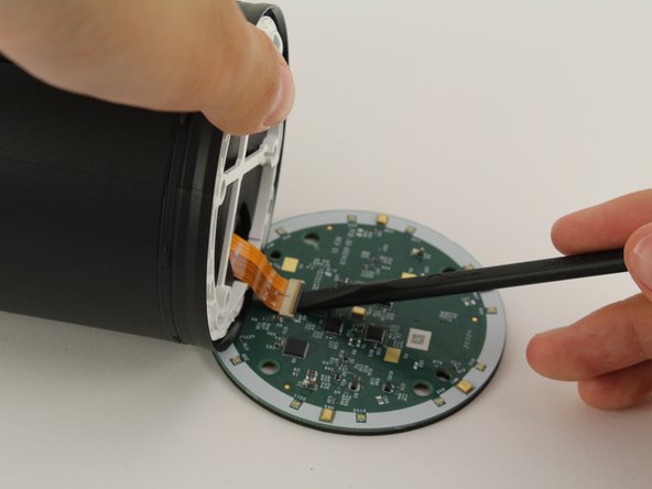

    1. Amazon Echo 2nd Generation MIC Board Replacement, MIC Board: crwdns2935265:07crwdnd2935265:01crwdnd2935265:03crwdne2935265:0 Amazon Echo 2nd Generation MIC Board Replacement, MIC Board: crwdns2935265:07crwdnd2935265:02crwdnd2935265:03crwdne2935265:0 Amazon Echo 2nd Generation MIC Board Replacement, MIC Board: crwdns2935265:07crwdnd2935265:03crwdnd2935265:03crwdne2935265:0
      • Lift the MIC board over and lay it down against a surface.
      • Use a spudger to flip up the small flap on the ZIF connector.
      • Disconnect the ribbon cable from the MIC board and pull the board away.
