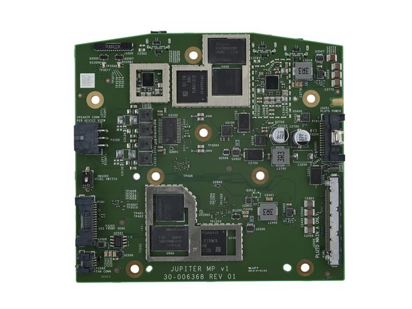

    1. Amazon Astro Chip ID, Screen Board Side 1: crwdns2935265:01crwdnd2935265:01crwdnd2935265:02crwdne2935265:0 Amazon Astro Chip ID, Screen Board Side 1: crwdns2935265:01crwdnd2935265:02crwdnd2935265:02crwdne2935265:0
      • Chip ID, part 1:
      • MediaTek MT8512BAAV applications processor w/ AZ1 neural edge
      • Samsung K4F8E164HA-MGCL 1 GB LPDDR4 SDRAM memory
      • Samsung KLM4G1FETE-B041 4 GB eMMC NAND flash memory
      • Qualcomm SDA660-201-AA octa-core applications processor
      • SK hynix H9HCNNNCPMMLHR-NME 4 GB LPDDR4X SDRAM memory
      • Kioxia THGBMJG7C1LBAIL 16 GB eMMC NAND flash memory
      • Analog Devices MAX9296A dual GMSL2 deserializer
    2. Amazon Astro Chip ID: crwdns2935265:02crwdnd2935265:01crwdnd2935265:01crwdne2935265:0
      • Chip ID, part 2:
      • MediaTek MT6398AN power management
      • Qualcomm PM660-002 power management
      • Qualcomm PM660L-004-01 power management
      • Qualcomm PM3003A power management
      • Monolithic Power Systems MP8756 6 A synchronous step-down converter
      • Richtek RT5797ALGQW 3 A synchronous step-down converter
      • Texas Instruments DC-DC converter (likely)
    3. Amazon Astro Chip ID: crwdns2935265:03crwdnd2935265:01crwdnd2935265:01crwdne2935265:0
      • Chip ID, part 3:
      • Silergy SY6287C power distribution switch
      • Texas Instruments INA219A 12-bit current/voltage/power monitor
      • Nexperia 74HC4051 8-ch analog multiplexer/demultiplexer
      • Nexperia 74AUP1G02 single 2-input NOR gate
      • Nexperia 74LVC1G08 single 2-input AND gate
      • onsemi ESD8704MUTAG 4-ch. ESD protection diode array
    4. Amazon Astro Chip ID: crwdns2935265:04crwdnd2935265:01crwdnd2935265:01crwdne2935265:0
      • Chip ID, part 4 - connectivity:
      • MediaTek MT7668ASN dual band 2x2 MU-MIMO WiFi 802.11ac & Bluetooth 5.0

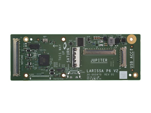

    5. Amazon Astro Chip ID, Neck Board Side 1: crwdns2935265:05crwdnd2935265:01crwdnd2935265:02crwdne2935265:0 Amazon Astro Chip ID, Neck Board Side 1: crwdns2935265:05crwdnd2935265:02crwdnd2935265:02crwdne2935265:0
      • Chip ID, part 1:
      • Intel vision processor (likely)
      • Knowles MEMS Microphone
      • Texas Instruments TPS24750 12 A eFuse w/ current monitor
      • Monolithic Power Systems MP2151GTF 1 A / adj. synchronous step-down converter
      • Renesas mixed signal array
    6. Amazon Astro Chip ID: crwdns2935265:06crwdnd2935265:01crwdnd2935265:01crwdne2935265:0
      • Chip ID, part 2:
      • Texas Instruments LP5907UVE-1.8 250 mA / 1.8 V LDO regulator
      • Texas Instruments TPS2553 adjustable USB power distribution switch
      • Texas Instruments TCA9406 2-bit bidirectional voltage-level translator
      • Texas Instruments LMV331 single low voltage comparator
      • NXP Semiconductor NVT2008 8-bit bidirectional voltage level translator
      • Texas Instruments SN74LVC1G66 single SPST analog switch
      • onsemi NC7SZ11 single 3-input AND gate
    7. Amazon Astro Chip ID: crwdns2935265:07crwdnd2935265:01crwdnd2935265:01crwdne2935265:0
      • Chip ID, part 3:
    8. Amazon Astro Chip ID: crwdns2935265:08crwdnd2935265:01crwdnd2935265:01crwdne2935265:0
      • Chip ID, part 4 - sensors:
      • Texas Instruments TMP103G temperature sensor

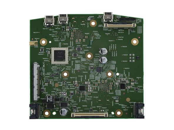

    9. Amazon Astro Chip ID, Sensor Board Side 1: crwdns2935265:09crwdnd2935265:01crwdnd2935265:02crwdne2935265:0 Amazon Astro Chip ID, Sensor Board Side 1: crwdns2935265:09crwdnd2935265:02crwdnd2935265:02crwdne2935265:0
      • Chip ID, part 1:
      • Qualcomm QCS605-001-AC 64-bit octa-core applications processor
      • SK hynix H9HCNNNBKMMLHR-NME 2 GB LPDDR4X SDRAM memory
      • Samsung KLMAG1JETD-B041 16 GB eMMC NAND flash memory
      • STMicroelectronics STM32G031J6 32-bit ARM Cortex-M0+ microcontroller
      • Qualcomm PM670-001 power management
      • Qualcomm PM670L-000-01 power management
      • Texas Instruments TLV320DAC3203 stereo audio CODEC
    10. Amazon Astro Chip ID: crwdns2935265:010crwdnd2935265:01crwdnd2935265:01crwdne2935265:0
      • Chip ID, part 2:
      • Texas Instruments TPA3118D2 stereo 30 W class-D audio amplifier
      • Silergy DC-DC converter (likely)
      • Vishay SiP32419 load switch
      • Silergy load switch (likely)
      • Texas Instruments LP5912-3.3 500 mA / 3.3 V LDO regulator
    11. Amazon Astro Chip ID: crwdns2935265:011crwdnd2935265:01crwdnd2935265:01crwdne2935265:0
      • Chip ID, part 3:
      • Texas Instruments TXS0102 2-bit bidirectional voltage-level translator
      • onsemi NL17SZ00 single 2-input NAND gate
      • onsemi ESD7104MUTAG 4-ch. ESD protection diode array
    12. Amazon Astro Chip ID: crwdns2935265:012crwdnd2935265:01crwdnd2935265:01crwdne2935265:0
      • Texas Instruments TMP103C temperature sensor
      • Texas Instruments TMP103D temperature sensor

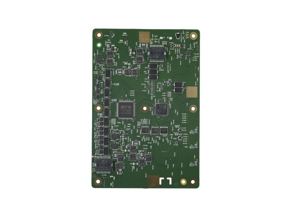

    16. Amazon Astro Chip ID, Motor Board Side 1: crwdns2935265:016crwdnd2935265:01crwdnd2935265:01crwdne2935265:0
      • Chip ID, part 1:
      • STMicroelectronics STM32L4P5VE 32-bit ARM Cortex-M4 microcontroller
      • SiTime MEMS Oscillator
      • Texas Instruments TPS3700 voltage detector
      • Renesas ISL9241H Li-ion buck boost battery charger
      • Texas Instruments DRV8323S 3-phase gate driver (for motor driving)
      • Texas Instruments TLA2024 12-bit analog-to-digital converter
    17. Amazon Astro Chip ID: crwdns2935265:017crwdnd2935265:01crwdnd2935265:01crwdne2935265:0
      • Chip ID, part 2:
      • Texas Instruments TPS60400 60 mA charge pump voltage inverter
      • Texas Instruments LM5166 500 mA synchronous buck converter
      • Vishay SiP32430 load switch
    18. Amazon Astro Chip ID: crwdns2935265:018crwdnd2935265:01crwdnd2935265:01crwdne2935265:0
      • Chip ID, part 3:
      • Nexperia 74AUP1G08 single 2-input AND gate
      • Nexperia 74AUP1G38 single 2-input NAND gate
    19. Amazon Astro Chip ID: crwdns2935265:019crwdnd2935265:01crwdnd2935265:01crwdne2935265:0
      • Invensense ICM-20689 6-axis MEMS accelerometer & gyroscope
      • Texas Instruments TMP1075 temperature sensor
      • Texas Instruments TMP103x temperature sensor (likely)
