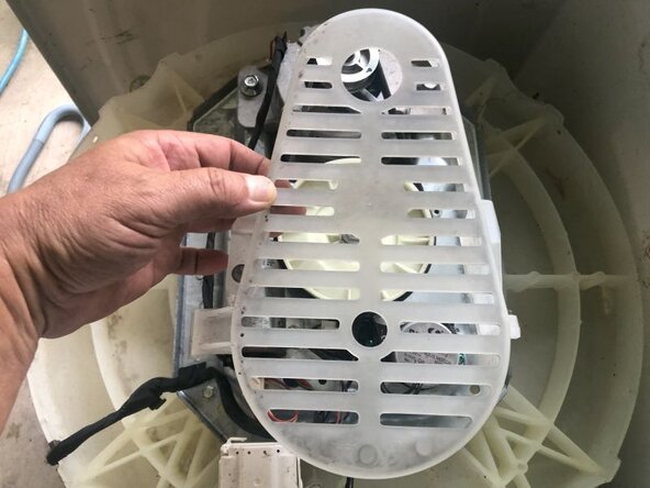

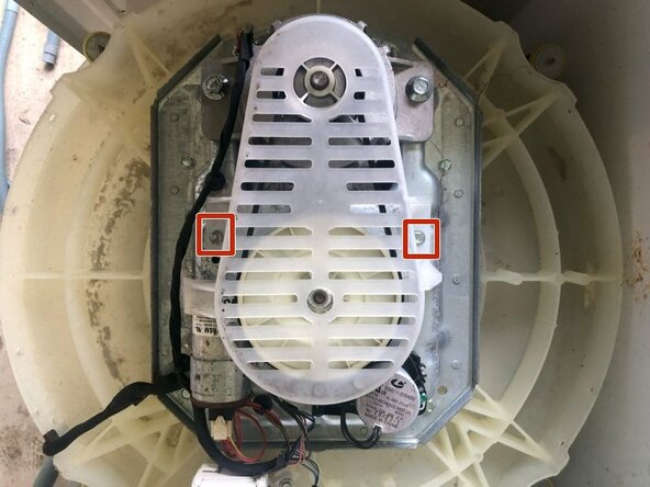

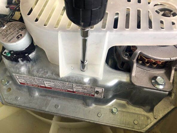

    • First the pulley cover has to be removed. It is attached via two 5/16 bolts
    • Use an electric screwdriver with a short extension and a 5/16 socket to remove the right screw,
  2. Amana Washing Machine NTW4516FW Shift Actuator Replacement: crwdns2935265:02crwdnd2935265:01crwdnd2935265:03crwdne2935265:0 Amana Washing Machine NTW4516FW Shift Actuator Replacement: crwdns2935265:02crwdnd2935265:02crwdnd2935265:03crwdne2935265:0 Amana Washing Machine NTW4516FW Shift Actuator Replacement: crwdns2935265:02crwdnd2935265:03crwdnd2935265:03crwdne2935265:0
    • followed by the left screw, is easiest. A hand ratchet or a nut driver will of course work as well.

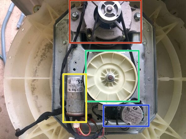

    • Remove the pulley cover

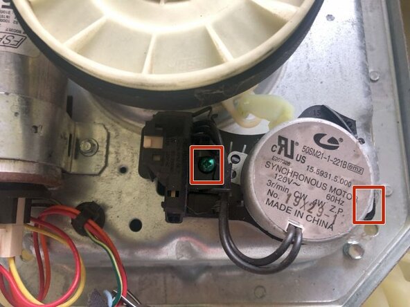

    • Now clearly visible are
    • The motor
    • The pulley for the drive (clutch/splutch is underneath)
    • The shift actuator
    • The start capacitor for the motor

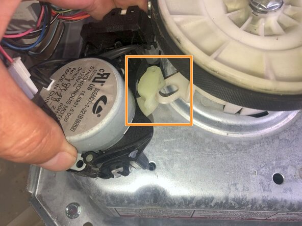

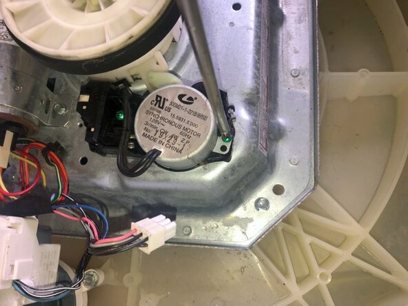

    • Here is a close up of the shift actuator

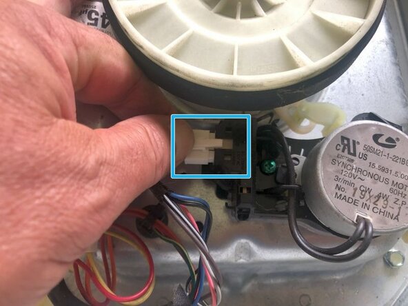

    • Remove the electrical connector by squeezing the locking tab down and pulling the connector off.
    • The actuator is held in place by two Philips head screws. Here they are actually using two green colored screws
  4. Amana Washing Machine NTW4516FW Shift Actuator Replacement: crwdns2935265:04crwdnd2935265:01crwdnd2935265:03crwdne2935265:0 Amana Washing Machine NTW4516FW Shift Actuator Replacement: crwdns2935265:04crwdnd2935265:02crwdnd2935265:03crwdne2935265:0 Amana Washing Machine NTW4516FW Shift Actuator Replacement: crwdns2935265:04crwdnd2935265:03crwdnd2935265:03crwdne2935265:0
    • Use a #2 Philips screwdriver to remove the left
    • and right screw.
    • Remove the actuator by pulling it up so that the pin clears the shifter assembly

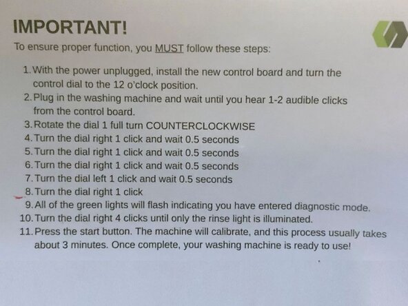

    • Calibration Cycle must be run whenever a main component i.e. main control, motor, pump etc. has been replaced. To run the cycle, use the instructions received from the seller of the actuator. Or you can use the Tech Sheet for this washer and follow the instructions on page 4
