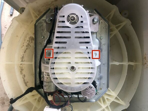

    • To work on this replacement, you will need to gain access to the bottom. It is best to place the washer on its front. Place a few old blankets etc. so as not to scratch the front to much. Since I did a total rebuild on this washer, I had also removed the control panel. It was easier for me to place the washer upside down :-)
    • Not shown here is that you need to unplug the washer as well as disconnect the water supply hoses prior to working on it!

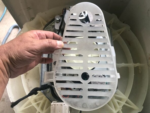

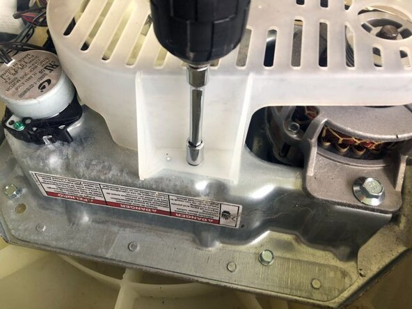

    • First the pulley cover has to be removed. It is attached via two 5/16 bolts
    • Use an electric screwdriver with a short extension and a 5/16 socket to remove the right screw,
  2. Amana Washing Machine NTW4516FW Clutch (Splutch) Replacement: crwdns2935265:02crwdnd2935265:01crwdnd2935265:03crwdne2935265:0 Amana Washing Machine NTW4516FW Clutch (Splutch) Replacement: crwdns2935265:02crwdnd2935265:02crwdnd2935265:03crwdne2935265:0 Amana Washing Machine NTW4516FW Clutch (Splutch) Replacement: crwdns2935265:02crwdnd2935265:03crwdnd2935265:03crwdne2935265:0
    • followed by the left screw, is easiest. A hand ratchet or a nut driver will of course work as well.

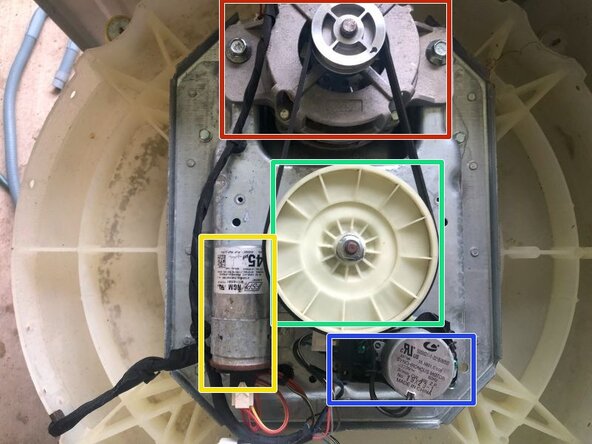

    • Remove the pulley cover

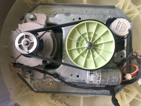

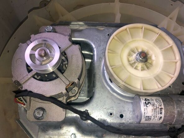

    • Now clearly visible are
    • The motor
    • The drive pulley
    • The shift actuator
    • The start capacitor for the motor

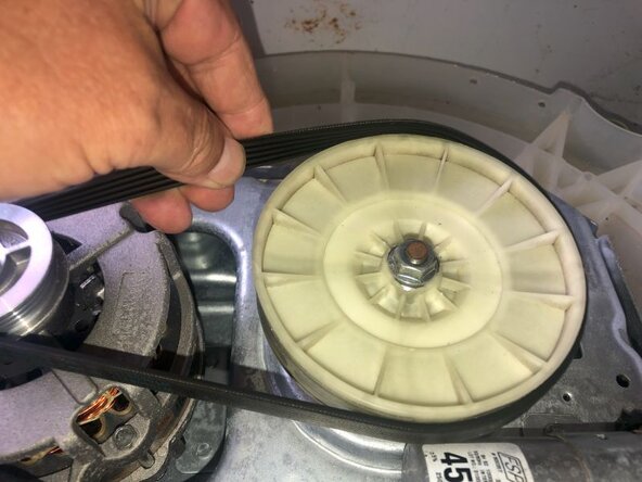

    • To remove the drive belt, lift one side up
    • and then pulling it to the drive pulley while continuing to pull up on it.
    • The belt will eventually run off the pulley

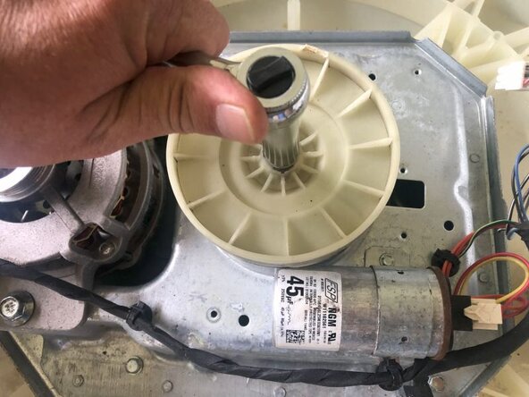

    • The pulley is held in place by a 13mm nut
    • Using a ratchet and socket to remove it.
    • Since the pulley will easily turn when using the ratchet, it is best to tap the ratchet handle by hand instead of trying a continues motion. It is common thread (Lefty Loosey). Of course, an impact wrench would be simpler :-)
    • The nut does come of fairly easy once it is loose.

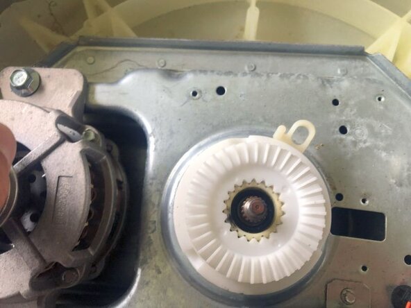

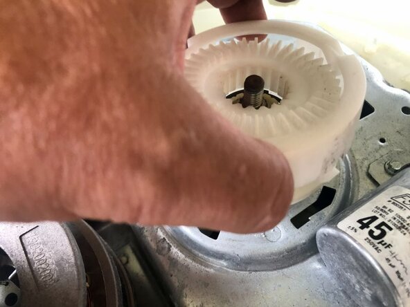

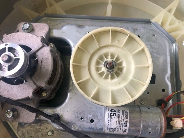

    • Remove the drive pulley from the shaft. Next is the drive basket gear.
    • The drive basket gear sits on a spline on the drive shaft. Check the spline on the basket drive shaft if the teeth on the basket gear show damage.

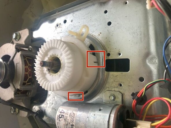

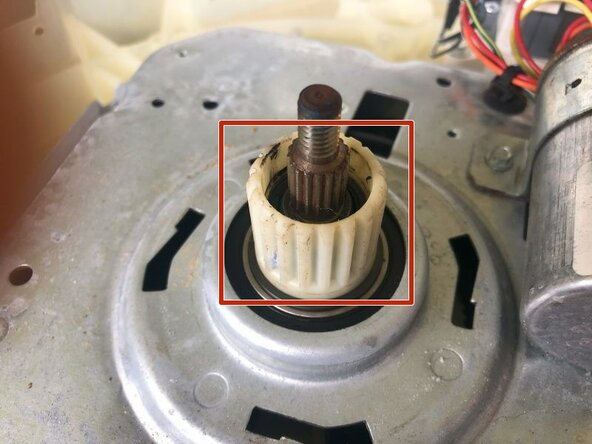

    • There are four tabs that hold the splatch housing to the gearcase
  6. Amana Washing Machine NTW4516FW Clutch (Splutch) Replacement: crwdns2935265:06crwdnd2935265:01crwdnd2935265:03crwdne2935265:0 Amana Washing Machine NTW4516FW Clutch (Splutch) Replacement: crwdns2935265:06crwdnd2935265:02crwdnd2935265:03crwdne2935265:0 Amana Washing Machine NTW4516FW Clutch (Splutch) Replacement: crwdns2935265:06crwdnd2935265:03crwdnd2935265:03crwdne2935265:0

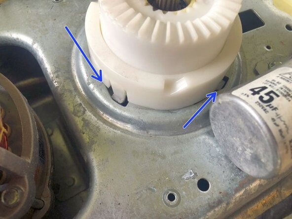

    • more of the latches of the splutch housing.
    • To remove it, simply twist the splutch housing into the direction of the slotted tabs (counter clock wise) until it comes free.
    • One the latches are cleared, lift the locking ring and the splutch housing to remove it from the shaft.

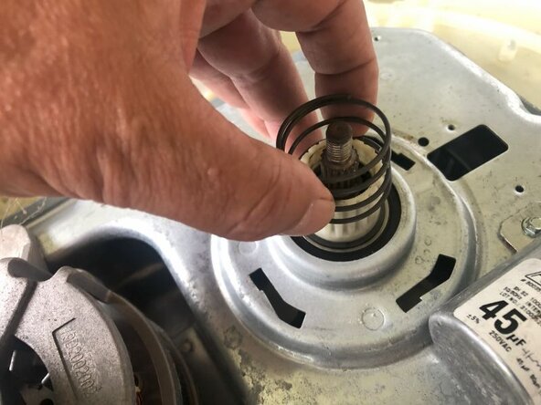

    • Remove the splutch spring.
    • Once more, check the spline on the drum drive for any damage
