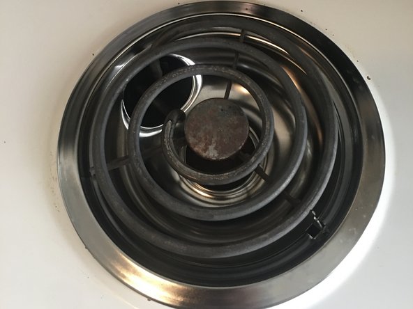

    • Turn the knob for the desired burner to full heat.
    • If there is an unusual amount of heat or no heat, continue.

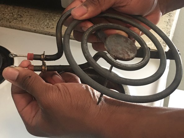

    • Remove the burner after it has cooled by grabbing the edge and carefully pulling the element at a slight upward angle.
  3. Amana Freestanding Electric Range Burners and Rims Replacement: crwdns2935265:03crwdnd2935265:01crwdnd2935265:01crwdne2935265:0
    • Clean the burner element end with a wire brush or a metal sponge.
  4. Amana Freestanding Electric Range Burners and Rims Replacement: crwdns2935265:04crwdnd2935265:01crwdnd2935265:02crwdne2935265:0 Amana Freestanding Electric Range Burners and Rims Replacement: crwdns2935265:04crwdnd2935265:02crwdnd2935265:02crwdne2935265:0
    • Take one end of the element and bend it by 3.2 mm to make better contact with the socket inside.

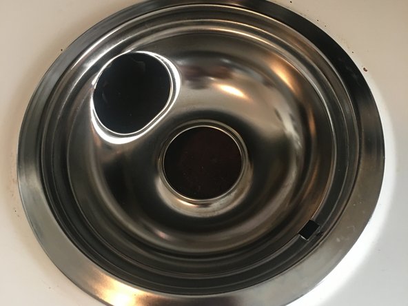

    • Place the new burner rim in the space with the hole for the element.
    • Make sure it is aligned with the socket.
