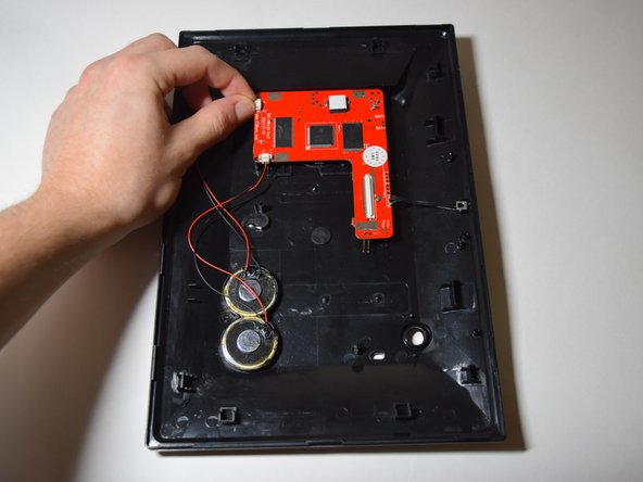

    • Unplug both plugs for the speakers to the motherboard

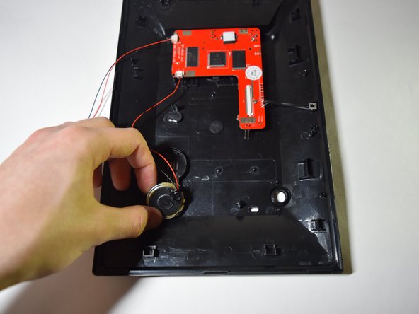

    • Use plastic opening tool to pull out one of the speakers.
    • Then use your hand to take out the other speaker
  5. Aluratek ADMPF310F Speakers Replacement: crwdns2935265:05crwdnd2935265:01crwdnd2935265:01crwdne2935265:0
    • Disconnect the wires off of the old speakers and solder the old wires onto the new speakers.
