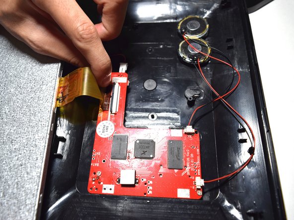

    • Using the plastic spudger tool lift the plastic zif(zero instertion force) connector clip up.
    • Pull the ribbon cable away from the motherboard.
    • Be careful as this clip is very frail.
  4. Aluratek ADMPF310F Screen Replacement: crwdns2935265:04crwdnd2935265:01crwdnd2935265:01crwdne2935265:0
    • Disconnect the red and black cable connecting the screen to the motherboard by just pulling it out.
