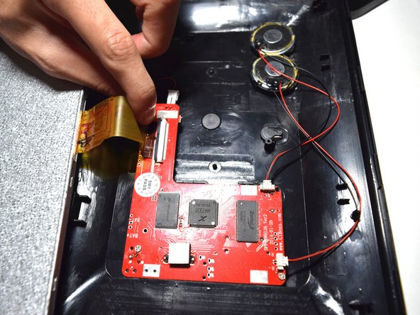

  4. Aluratek ADMPF310F Replacing USB Port Replacement: crwdns2935265:04crwdnd2935265:01crwdnd2935265:01crwdne2935265:0
    • Disconnect the red and black cable connecting the screen to the motherboard by just pulling it out.
  5. Aluratek ADMPF310F Replacing USB Port Replacement: crwdns2935265:05crwdnd2935265:01crwdnd2935265:01crwdne2935265:0
    • Pull out remote receiver out of its clip.
    • Be careful to not move the wires around for the remote receiver too much, as they are soldered to the motherboard.

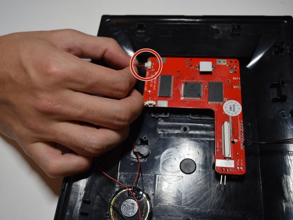

  6. Aluratek ADMPF310F Replacing USB Port Replacement: crwdns2935265:06crwdnd2935265:01crwdnd2935265:02crwdne2935265:0 Aluratek ADMPF310F Replacing USB Port Replacement: crwdns2935265:06crwdnd2935265:02crwdnd2935265:02crwdne2935265:0
    • Using fingers pull the first speaker wire that is located closest to the speakers
    • Again using your fingers, pull out the second speaker wire near the far side of the motherboard.

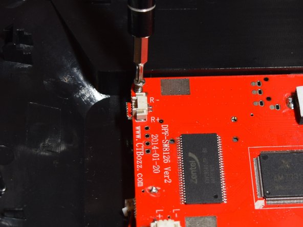

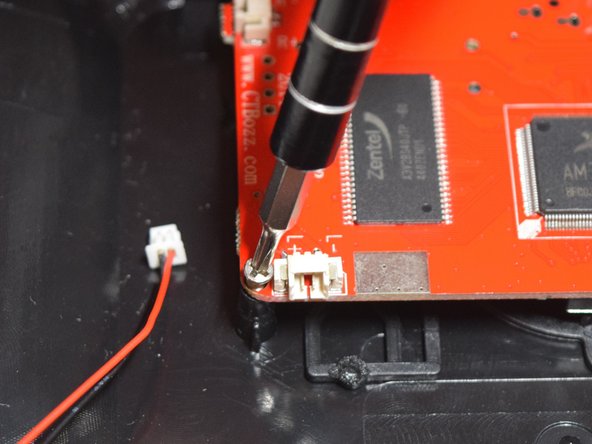

    • Using the ph0 phillips head screwdriver unscrew the four 4mm screws circled in the picture.
  8. Aluratek ADMPF310F Replacing USB Port Replacement: crwdns2935265:08crwdnd2935265:01crwdnd2935265:01crwdne2935265:0
    • Pull up the smaller end of the motherboard.
    • Apply force pulling away from the USB ports to get the mother board out of place.
  9. Aluratek ADMPF310F Replacing USB Port Replacement, USB Port: crwdns2935265:09crwdnd2935265:01crwdnd2935265:01crwdne2935265:0
    • On the back end of the mother board unsolder the USB port at the two points shown.
