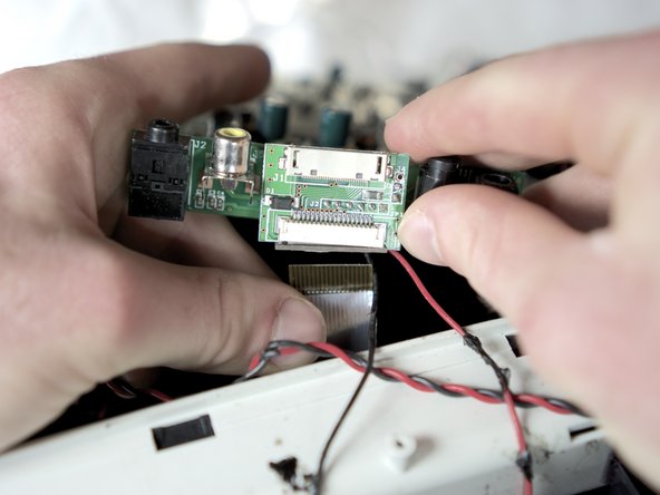

  19. Altec Lansing inMotion iM9 iPod Dock Replacement: crwdns2935265:019crwdnd2935265:01crwdnd2935265:01crwdne2935265:0
    • Use the pointed end of the plastic spudger to pry the glue off of the iPod dock. You will probably have to use some force.
  20. Altec Lansing inMotion iM9 iPod Dock Replacement: crwdns2935265:020crwdnd2935265:01crwdnd2935265:02crwdne2935265:0 Altec Lansing inMotion iM9 iPod Dock Replacement: crwdns2935265:020crwdnd2935265:02crwdnd2935265:02crwdne2935265:0
    • Unlock the ribbon cable dock by pressing down on the two tabs at the bottom of the dock.
    • Detach the copper ribbon cable by gently pulling it down, freeing the motherboard completely.
  21. Altec Lansing inMotion iM9 iPod Dock Replacement, iPod Dock: crwdns2935265:021crwdnd2935265:01crwdnd2935265:01crwdne2935265:0
    • To remove the iPod Dock, unscrew the four 8mm screws located on the corners of the dock casing using the Phillips #1 screwdriver.
  22. Altec Lansing inMotion iM9 iPod Dock Replacement: crwdns2935265:022crwdnd2935265:01crwdnd2935265:01crwdne2935265:0
    • Remove the iPod Dock from the speaker.
