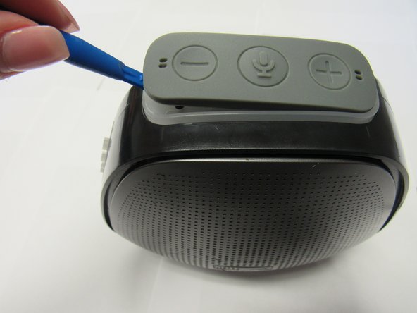

    • Orient speaker so volume buttons are facing up.
    • Remove rubber button piece using the blue plastic opening tool.

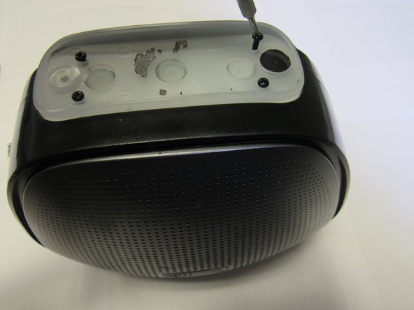

    • Remove the four 9mm screws using the Torx T5 screwdriver.

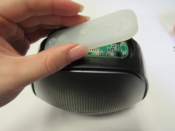

    • Once screws are removed, remove the plastic covering piece.
    • Remove the rubber piece below the plactic covering piece to expose the daughterboard.

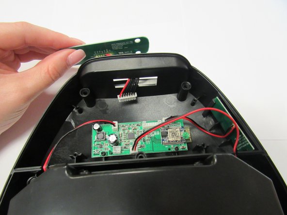

    • Orient speaker on its side with volume buttons facing away from you and Bluetooth and power buttons on the right.
    • Detach the wiring, located in the upper middle section of the motherboard.
    • Remove daughterboard piece from opening in the top of the speaker.
