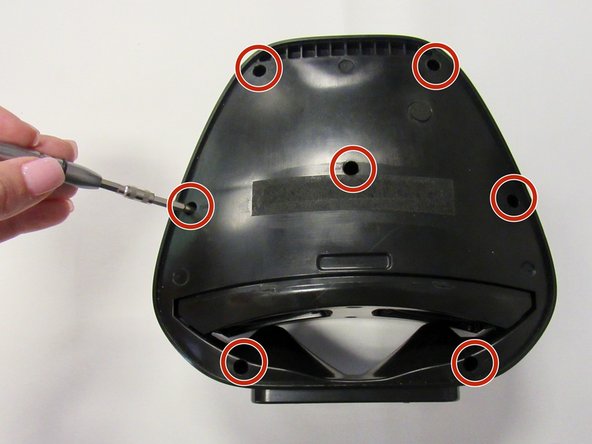

  3. Altec Lansing VersA Smart Speaker Head Replacement: crwdns2935265:03crwdnd2935265:01crwdnd2935265:02crwdne2935265:0 Altec Lansing VersA Smart Speaker Head Replacement: crwdns2935265:03crwdnd2935265:02crwdnd2935265:02crwdne2935265:0
    • Orient speaker so volume buttons are facing away from you, and Bluetooth and power buttons are on the left-hand side.
    • Remove the seven 14mm screws using the Phillips #1 screwdriver.

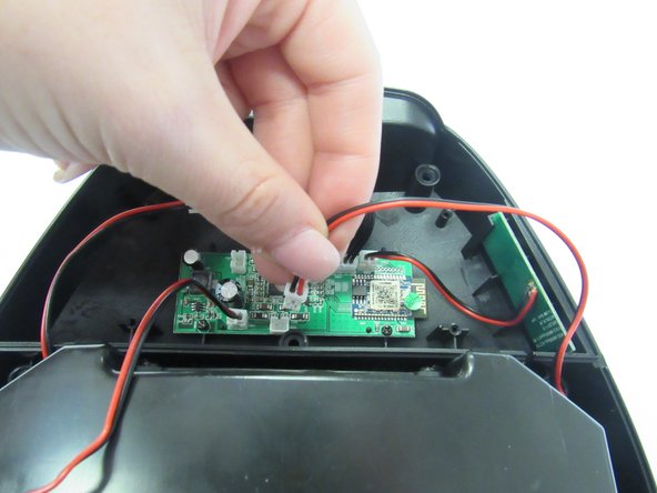

  4. Altec Lansing VersA Smart Speaker Head Replacement: crwdns2935265:04crwdnd2935265:01crwdnd2935265:01crwdne2935265:0
    • Reorient speaker so Bluetooth and power buttons are now on the right-hand side.
    • Separate the two panels along the crease.
    • Blue plastic opening tool may be needed to separate panels.
    • Remove the panel with no buttons to expose internal area of the device.
    • Motherboard and all internal components are under this panel.
  5. Altec Lansing VersA Smart Speaker Head Replacement, Speaker Head: crwdns2935265:05crwdnd2935265:01crwdnd2935265:03crwdne2935265:0 Altec Lansing VersA Smart Speaker Head Replacement, Speaker Head: crwdns2935265:05crwdnd2935265:02crwdnd2935265:03crwdne2935265:0 Altec Lansing VersA Smart Speaker Head Replacement, Speaker Head: crwdns2935265:05crwdnd2935265:03crwdnd2935265:03crwdne2935265:0
    • Detach the two wire connections from the motherboard.
    • Remove the speaker bed from the internal cavity of the device.

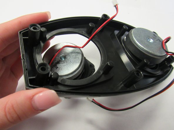

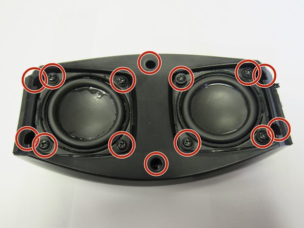

    • Orient speaker bed so the speaker heads are facing up.
    • Remove the two 14mm screws using the Phillips #1 screwdriver.
  7. Altec Lansing VersA Smart Speaker Head Replacement: crwdns2935265:07crwdnd2935265:01crwdnd2935265:02crwdne2935265:0 Altec Lansing VersA Smart Speaker Head Replacement: crwdns2935265:07crwdnd2935265:02crwdnd2935265:02crwdne2935265:0

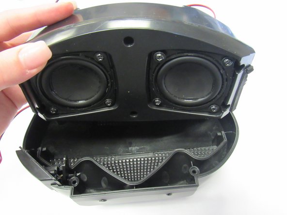

    • Separate the two plastic pieces of the speaker bed.
    • Flip the top plastic piece so the speaker heads are face down.
    • Speaker heads may fall out on their own.
    • Remove the two speaker heads.
