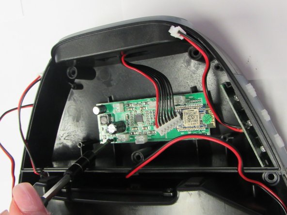

  5. Altec Lansing VersA Smart Motherboard Replacement, Motherboard: crwdns2935265:05crwdnd2935265:01crwdnd2935265:01crwdne2935265:0
    • Remove the five wiring attachments (for the volume board, bluetooth board, speakers, and microUSB) from their connection to the motherboard by pulling slightly.
  6. Altec Lansing VersA Smart Motherboard Replacement: crwdns2935265:06crwdnd2935265:01crwdnd2935265:02crwdne2935265:0 Altec Lansing VersA Smart Motherboard Replacement: crwdns2935265:06crwdnd2935265:02crwdnd2935265:02crwdne2935265:0
    • Remove the two 9mm screws holding the motherboard in place using the Torx T5 screwdriver.
  7. Altec Lansing VersA Smart Motherboard Replacement: crwdns2935265:07crwdnd2935265:01crwdnd2935265:01crwdne2935265:0
    • Remove the motherboard.
