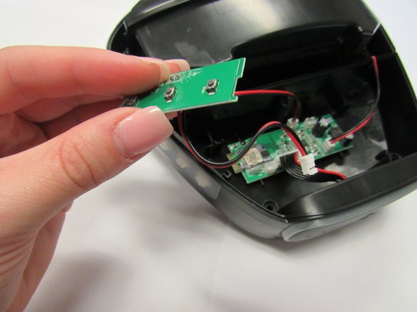

  5. Altec Lansing VersA Smart Bluebooth Board Replacement, Bluebooth Board: crwdns2935265:05crwdnd2935265:01crwdnd2935265:01crwdne2935265:0
    • Detach the wiring piece, located in the upper right corner of the motherboard.
  6. Altec Lansing VersA Smart Bluebooth Board Replacement: crwdns2935265:06crwdnd2935265:01crwdnd2935265:02crwdne2935265:0 Altec Lansing VersA Smart Bluebooth Board Replacement: crwdns2935265:06crwdnd2935265:02crwdnd2935265:02crwdne2935265:0
    • Remove the daughterboard piece from its designated slot, located to the right of the motherboard.
