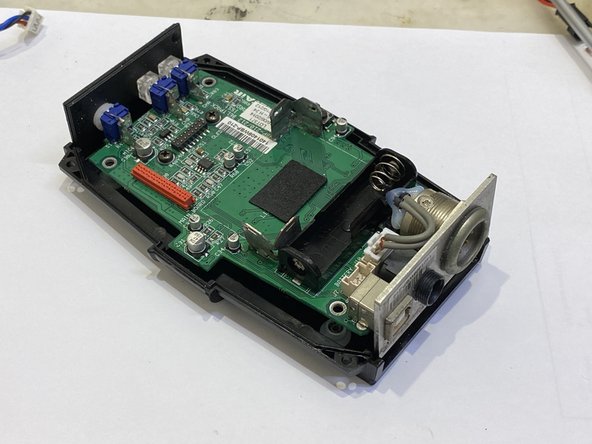

  4. Altair WBP-210 Mini-XLR socket Replacement, Open case: crwdns2935265:04crwdnd2935265:01crwdnd2935265:02crwdne2935265:0 Altair WBP-210 Mini-XLR socket Replacement, Open case: crwdns2935265:04crwdnd2935265:02crwdnd2935265:02crwdne2935265:0
    • Separate the two halves of the case using a suitable tool.
    • Pay attention to the ribbon cable connecting the two halves.
    • The top and bottom panels stay attached to the front of the case.

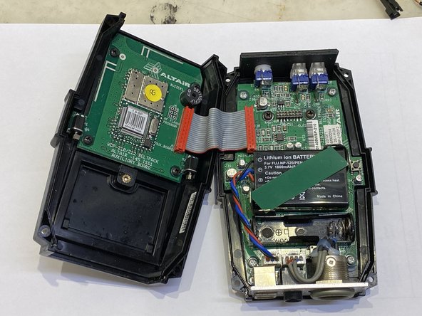

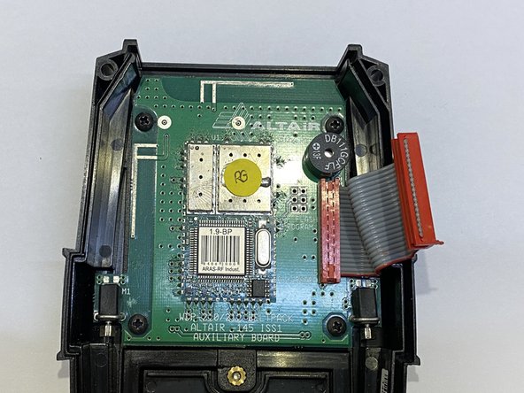

  5. Altair WBP-210 Mini-XLR socket Replacement, Disconnect Auxiliary Board: crwdns2935265:05crwdnd2935265:01crwdnd2935265:02crwdne2935265:0 Altair WBP-210 Mini-XLR socket Replacement, Disconnect Auxiliary Board: crwdns2935265:05crwdnd2935265:02crwdnd2935265:02crwdne2935265:0
    • Disconnect the Auxiliary Board from the Main Board and put it aside.

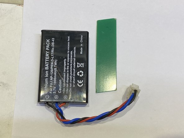

  6. Altair WBP-210 Mini-XLR socket Replacement, Remove battery: crwdns2935265:06crwdnd2935265:01crwdnd2935265:02crwdne2935265:0 Altair WBP-210 Mini-XLR socket Replacement, Remove battery: crwdns2935265:06crwdnd2935265:02crwdnd2935265:02crwdne2935265:0
    • Disconnect the battery connector.
    • Gently remove the strip of PCB holding the battery in place.

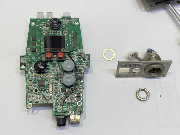

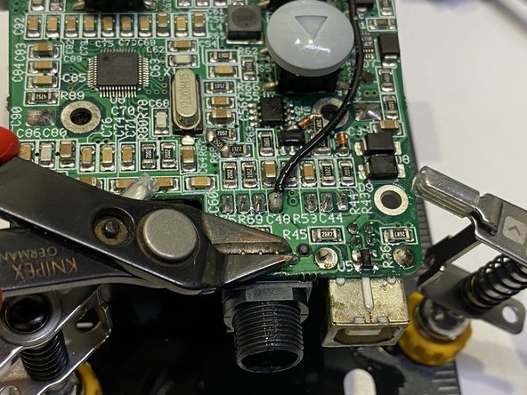

  8. Altair WBP-210 Mini-XLR socket Replacement, Replace Mini-XLR4 connector: crwdns2935265:08crwdnd2935265:01crwdnd2935265:03crwdne2935265:0 Altair WBP-210 Mini-XLR socket Replacement, Replace Mini-XLR4 connector: crwdns2935265:08crwdnd2935265:02crwdnd2935265:03crwdne2935265:0 Altair WBP-210 Mini-XLR socket Replacement, Replace Mini-XLR4 connector: crwdns2935265:08crwdnd2935265:03crwdnd2935265:03crwdne2935265:0
    • Desolder the defective connector.
    • It is held in place by 4 pins, no additional pads.
    • Matching replacement part is Switchcraft TRAPC4MSX
    • Amphenol AG4MPCH and Kuilong YA137-2 might fit too.
    • Re-solder the new connector.

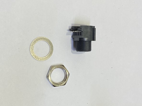

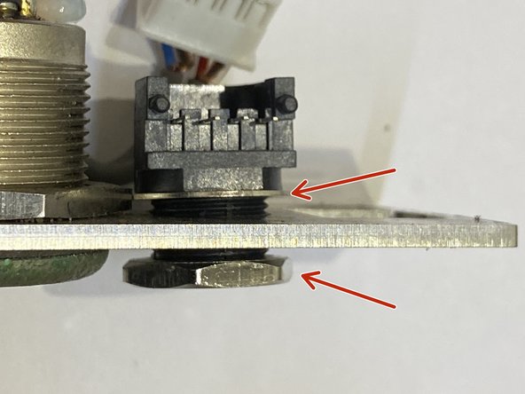

  9. Altair WBP-210 Mini-XLR socket Replacement, Assemble lower cover plate.: crwdns2935265:09crwdnd2935265:01crwdnd2935265:02crwdne2935265:0 Altair WBP-210 Mini-XLR socket Replacement, Assemble lower cover plate.: crwdns2935265:09crwdnd2935265:02crwdnd2935265:02crwdne2935265:0
    • Reassemble the lower cover plate.
    • Pay attention to the location of the washer.
    • Tighten the nut on new connector.
When reassembling, take care to only connect the battery after connecting the Auxiliary Board.
