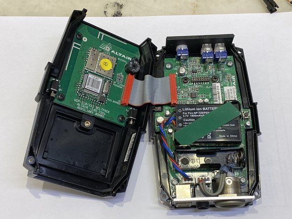

  3. Altair WBP-210 Full Disassembly, Open case: crwdns2935265:03crwdnd2935265:01crwdnd2935265:02crwdne2935265:0 Altair WBP-210 Full Disassembly, Open case: crwdns2935265:03crwdnd2935265:02crwdnd2935265:02crwdne2935265:0
    • Open the case using a suitable tool to help separate the two halves.
    • Watch out for the ribbon cable.
  4. Altair WBP-210 Full Disassembly, Remove back case.: crwdns2935265:04crwdnd2935265:01crwdnd2935265:02crwdne2935265:0 Altair WBP-210 Full Disassembly, Remove back case.: crwdns2935265:04crwdnd2935265:02crwdnd2935265:02crwdne2935265:0
    • Disconnect the back half of the case.

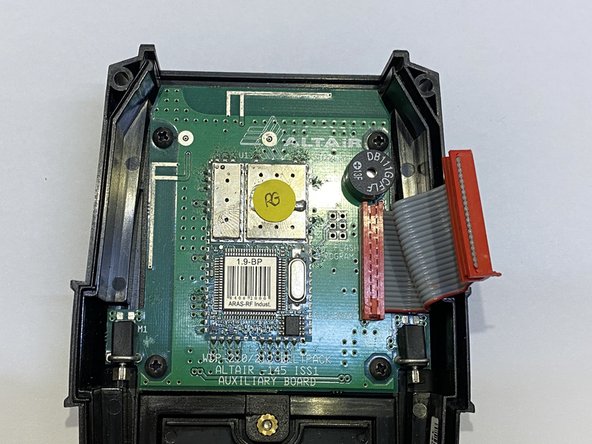

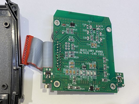

  5. Altair WBP-210 Full Disassembly, Remove Auxiliary Board: crwdns2935265:05crwdnd2935265:01crwdnd2935265:02crwdne2935265:0 Altair WBP-210 Full Disassembly, Remove Auxiliary Board: crwdns2935265:05crwdnd2935265:02crwdnd2935265:02crwdne2935265:0
    • There are four screws holding the Auxiliary Board in place.

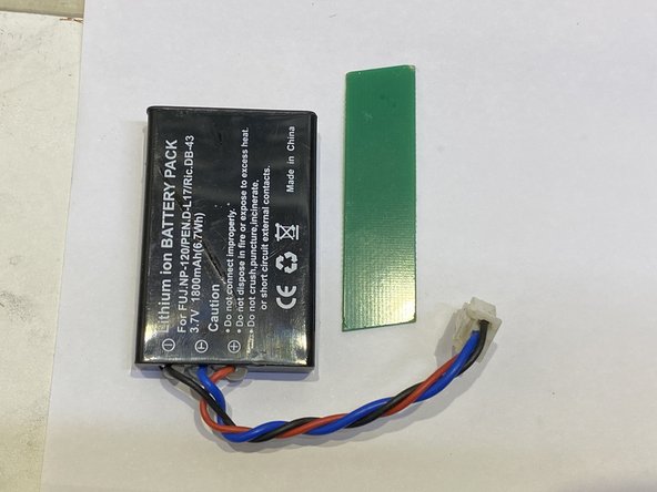

  6. Altair WBP-210 Full Disassembly, Remove Battery: crwdns2935265:06crwdnd2935265:01crwdnd2935265:02crwdne2935265:0 Altair WBP-210 Full Disassembly, Remove Battery: crwdns2935265:06crwdnd2935265:02crwdnd2935265:02crwdne2935265:0
    • The battery is held in place by a flexible bit of PCB, which can be carefully removed.

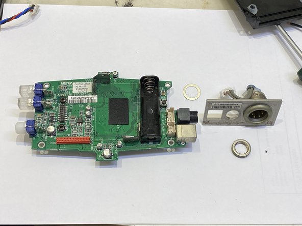

  7. Altair WBP-210 Full Disassembly, Remove main board: crwdns2935265:07crwdnd2935265:01crwdnd2935265:02crwdne2935265:0 Altair WBP-210 Full Disassembly, Remove main board: crwdns2935265:07crwdnd2935265:02crwdnd2935265:02crwdne2935265:0
    • The main PCB is held in place by four screws.
