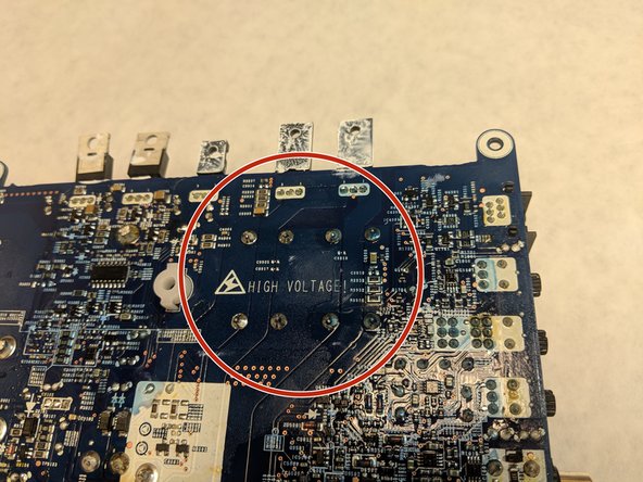

    • Find the faulty capacitor.
    • Flip the board over and locate the corresponding pins.
    • If the faulty capacitor is one of the smaller ones, it may be too difficult to replace and replacing the circuit board itself may be easier.
    • Make sure that the capacitance and voltage rating of the new capacitor match that of the original.
  4. Alpine MRV-M500 Electrolytic Capacitor Replacement: crwdns2935265:04crwdnd2935265:01crwdnd2935265:01crwdne2935265:0
    • Desolder the pins to remove the capacitor.
    • Solder the new capacitor into its place.
    • Make sure the polarity of the new capacitor matches the previous polarity.
