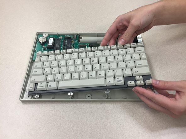

  3. AlphaSmart Pro Motherboard Replacement, Prepping Keyboard For Removal: crwdns2935265:03crwdnd2935265:01crwdnd2935265:03crwdne2935265:0 AlphaSmart Pro Motherboard Replacement, Prepping Keyboard For Removal: crwdns2935265:03crwdnd2935265:02crwdnd2935265:03crwdne2935265:0 AlphaSmart Pro Motherboard Replacement, Prepping Keyboard For Removal: crwdns2935265:03crwdnd2935265:03crwdnd2935265:03crwdne2935265:0
    • Use the Phillips #00 Screwdriver to remove the four 1 cm screws from each corner of the keyboard.
    • Gently lift the keyboard from the rear panel.
    • Notice that the keyboard is still connected to the motherboard by two ribbon cables.

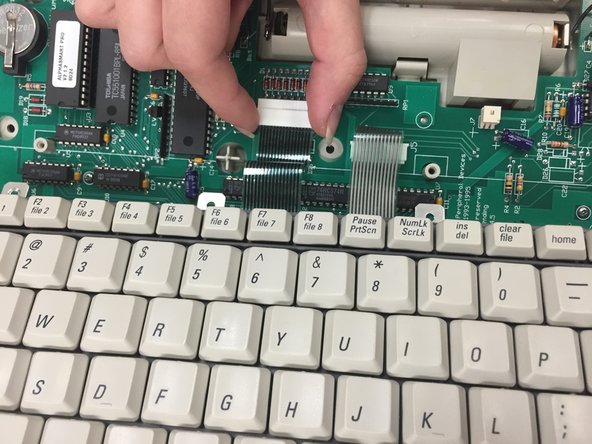

  4. AlphaSmart Pro Motherboard Replacement, Detaching keyboard Ribbon Cables: crwdns2935265:04crwdnd2935265:01crwdnd2935265:03crwdne2935265:0 AlphaSmart Pro Motherboard Replacement, Detaching keyboard Ribbon Cables: crwdns2935265:04crwdnd2935265:02crwdnd2935265:03crwdne2935265:0 AlphaSmart Pro Motherboard Replacement, Detaching keyboard Ribbon Cables: crwdns2935265:04crwdnd2935265:03crwdnd2935265:03crwdne2935265:0
    • To remove the ribbon cable, gently pull the connector in the direction of the ribbon cable.
    • Pull the ribbon cable to remove it from the connector.

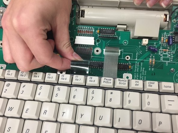

    • Repeat the exact steps above for the other ribbon cable.
    • While the large connector on the left must be pulled toward you in order to remove the ribbon cable, the smaller connector on the right must be pushed away from you.
  5. AlphaSmart Pro Motherboard Replacement: crwdns2935265:05crwdnd2935265:01crwdnd2935265:01crwdne2935265:0
    • Remove keyboard from motherboard.

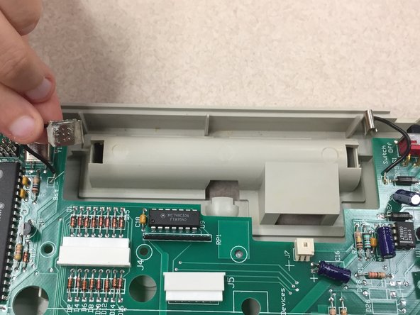

    • Flip the AlphaSmart Pro over so that the rear panel is facing upward.
    • Using a spludger, carefully disconnect the battery prongs, located in the battery compartment.

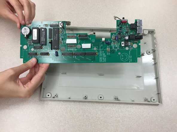

  7. AlphaSmart Pro Motherboard Replacement, Separating Motherboard From Rear Panel.: crwdns2935265:07crwdnd2935265:01crwdnd2935265:02crwdne2935265:0 AlphaSmart Pro Motherboard Replacement, Separating Motherboard From Rear Panel.: crwdns2935265:07crwdnd2935265:02crwdnd2935265:02crwdne2935265:0
    • Using a Phillips #00 Screwdriver, remove the four 0.8 cm screws from the motherboard.
    • Carefully lift the motherboard away from the rear panel.
