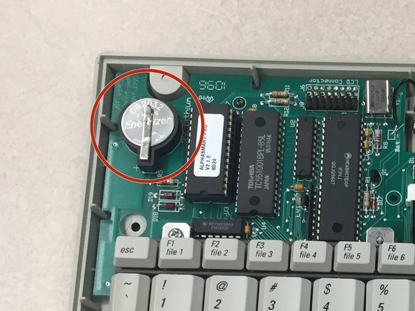

  3. AlphaSmart Pro Lithium Coin Battery Replacement, Locate Lithium Coin Battery: crwdns2935265:03crwdnd2935265:01crwdnd2935265:02crwdne2935265:0 AlphaSmart Pro Lithium Coin Battery Replacement, Locate Lithium Coin Battery: crwdns2935265:03crwdnd2935265:02crwdnd2935265:02crwdne2935265:0
    • With the front panel removed, locate the lithium coin battery at the top left corner of the motherboard.

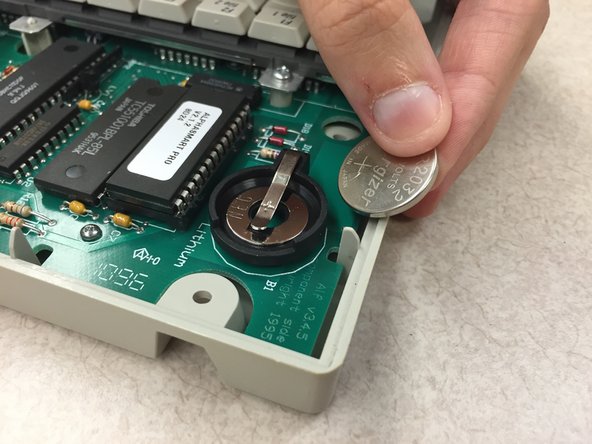

  4. AlphaSmart Pro Lithium Coin Battery Replacement, Remove Lithium Coin Battery: crwdns2935265:04crwdnd2935265:01crwdnd2935265:02crwdne2935265:0 AlphaSmart Pro Lithium Coin Battery Replacement, Remove Lithium Coin Battery: crwdns2935265:04crwdnd2935265:02crwdnd2935265:02crwdne2935265:0
    • Use the spudger, plastic opening tool, or your finger/fingernail to lift up the lithium coin battery.
    • Slide the battery out from underneath the clip that holds it in place.
    • The positive side of the battery is facing up.
